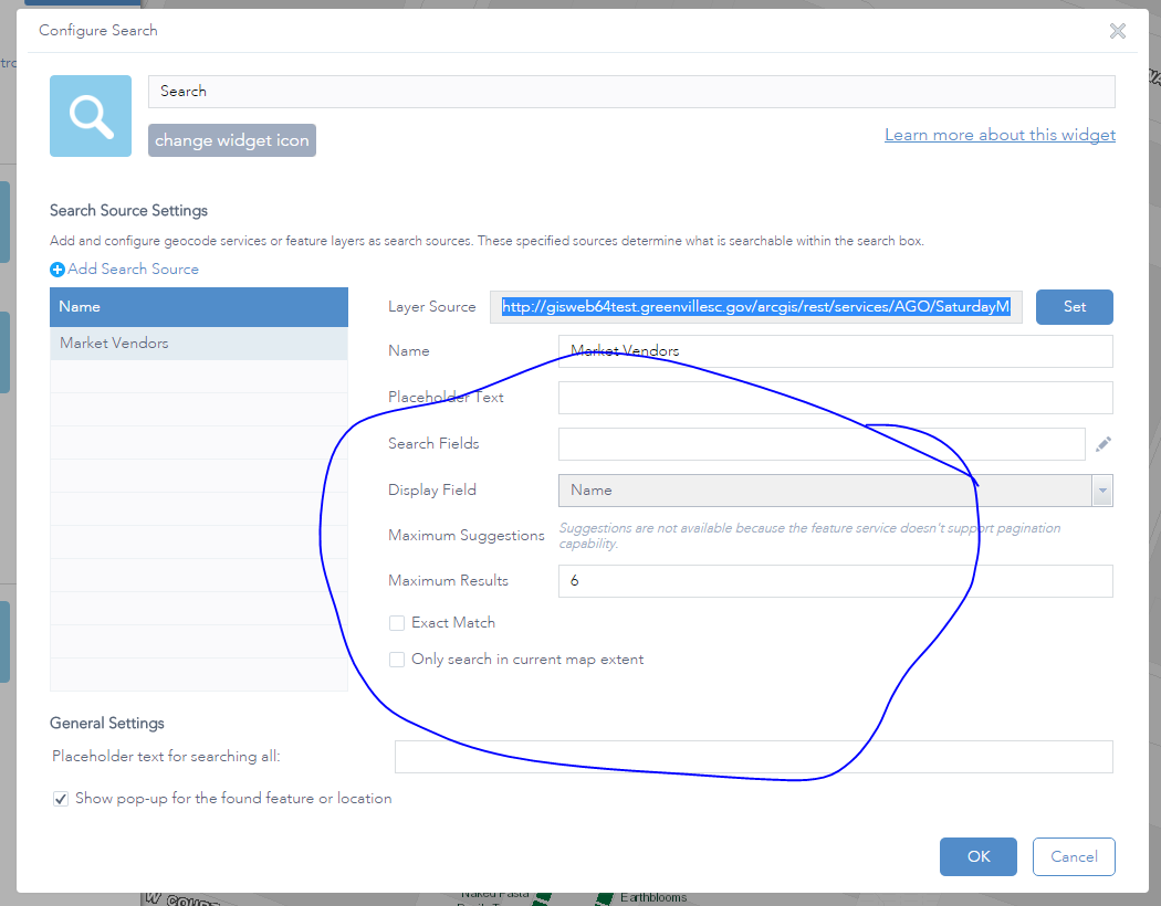

For some reason I'm not able to configure the Zoom Scale on the search widget using the following feature layer:
Layer: Market Vendors (ID: 0)
The other layers in that same map service work but for some reason this one won't. The box for Zoom Scale just isn't available. Am I missing something?
Scott
Scott,
ZoomScale is only available for those layer that do not return a extent like points. As your layer is a polygon the zoomScale would not be used thus the option is not available.
