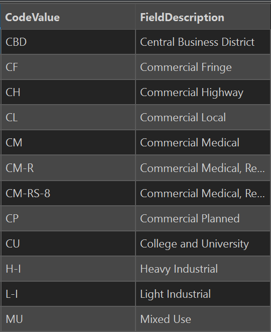

I am using ArcPro 3.0 to publish a feature layer from an enterprise geodatabase. Is there a way to turn off the domain descriptions before publishing? I trying to end up with the published layer only having the domain code in the table and not description. I'm trying to do this without messing with the schema of the layer.
Publish this Not this
