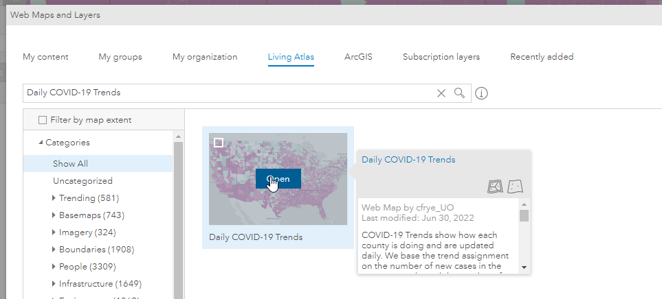

2. Click on the Living Atlas tab > and search for "Daily COVID-19 Trends"
3. Click Open to add it to the map.

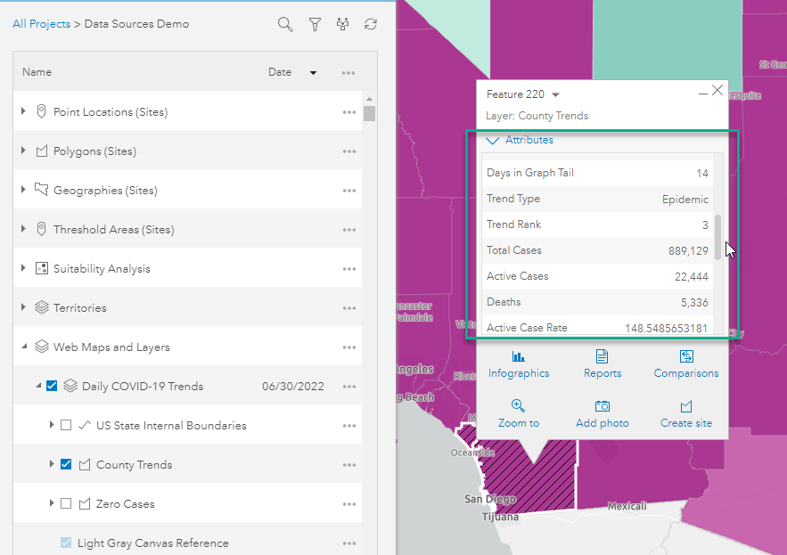

4. Click on one of the counties on the map and expand the attributes. We will build a sample infographics using some of these attributes.

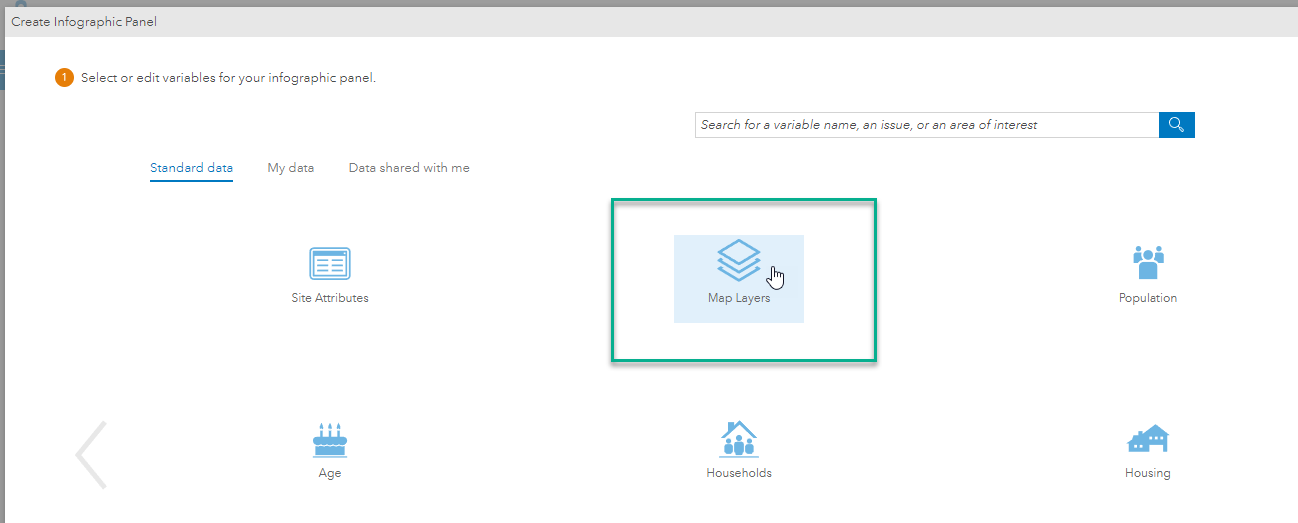

7. You will see the Map Layers category. Click and open it. Please note that this option becomes available only when you have map layer on the map.
8. You will see two layers listed for the Daily COVID-19 Trends web map you added above. Expand the County Trends (Map Layers) and select the following 3 variables: Total Cases, Trend Rank, and Trend Type

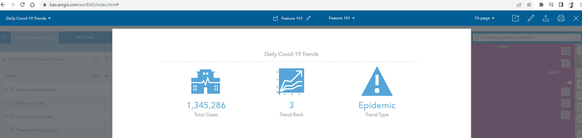

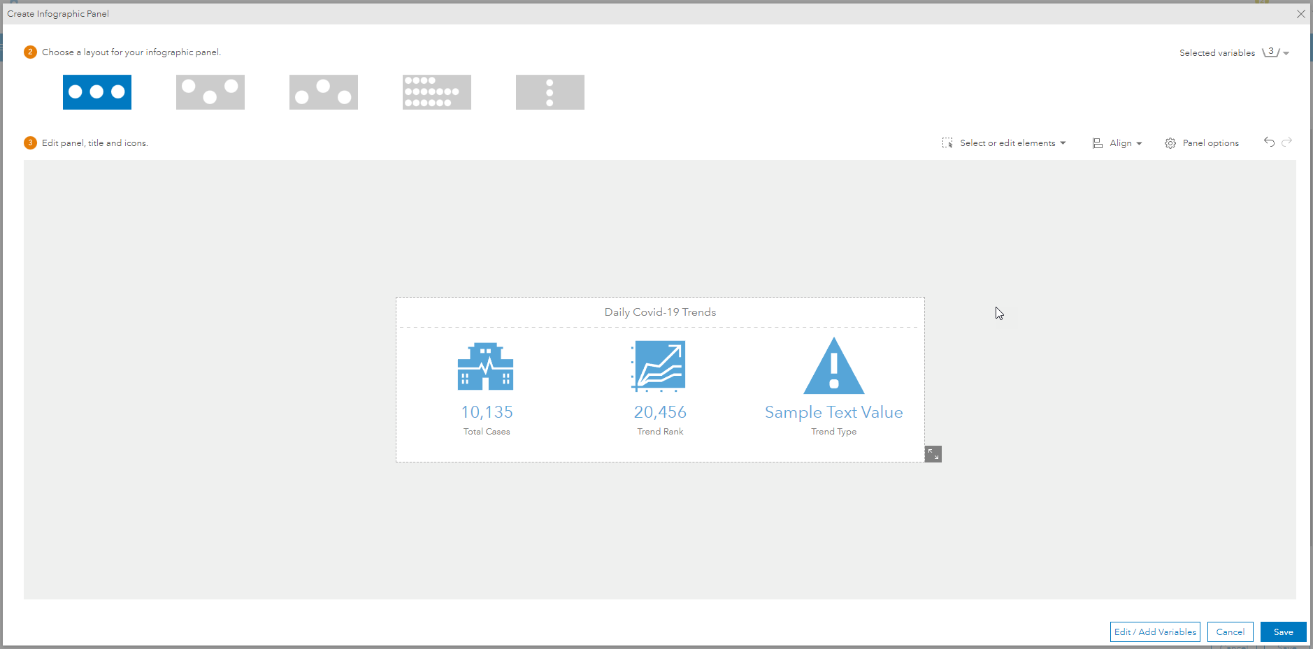

9. You can further customize your infographic panel to look something like this.
10. Save the panel and add it to your template. Then save the template.

Since the data source is updated daily, this infographics will show the latest values from today. Now, let's export this to a dynamic HTML.

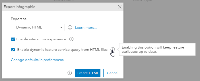

3. Click Export infographic and select Dynamic HTML from the list. Notice the option to Enable dynamic feature query from HTML files is available because the infographic template contains attributes from a Map Layers data source.
4. When this option is enabled, the exported infographic HTML will automatically update with the latest data from the feature/map layer whenever you open or refresh it. Please note that the data source (feature/map layer) must be publicly accessible for this functionality.

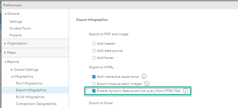

1.Go to Preferences > Reports > Infographics > Export infographics > check this option:
2. Click Save and Close

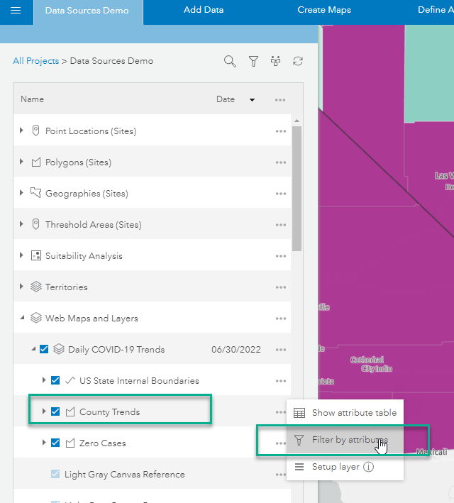

4. Expand the project table of contents and click the Filter by attributes option for the County Trends layer.
5. Filter the layer using State Abbr. and selecting AZ from the list. Notice only the counties in Arizona are shown on the map now. Click Done.

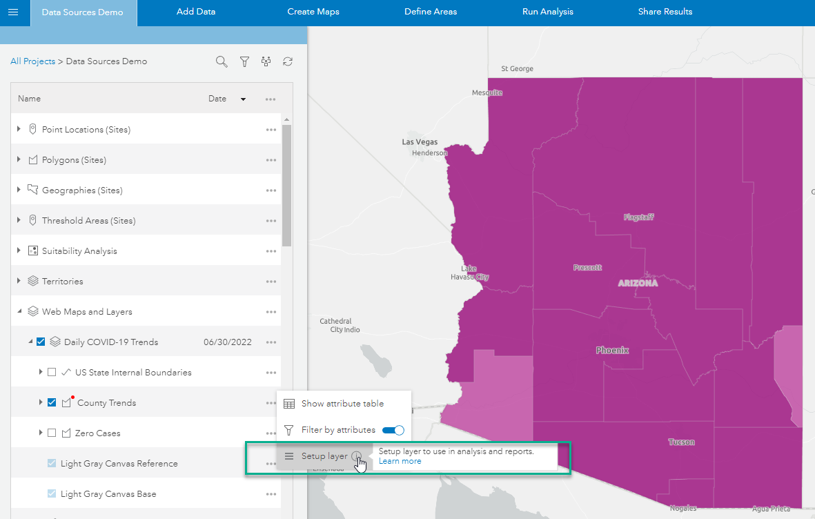

6. Click the action option for the County Trends layer again and click Setup layer to prepare the layer for use in analysis and reports.
7. Select County Name as item name and click Setup Layer
8. You can leave the default Polygon layer option and click OK.

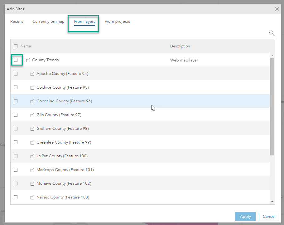

11. Click Add Sites and select the From layers tab. Select all counties in Arizona and Apply

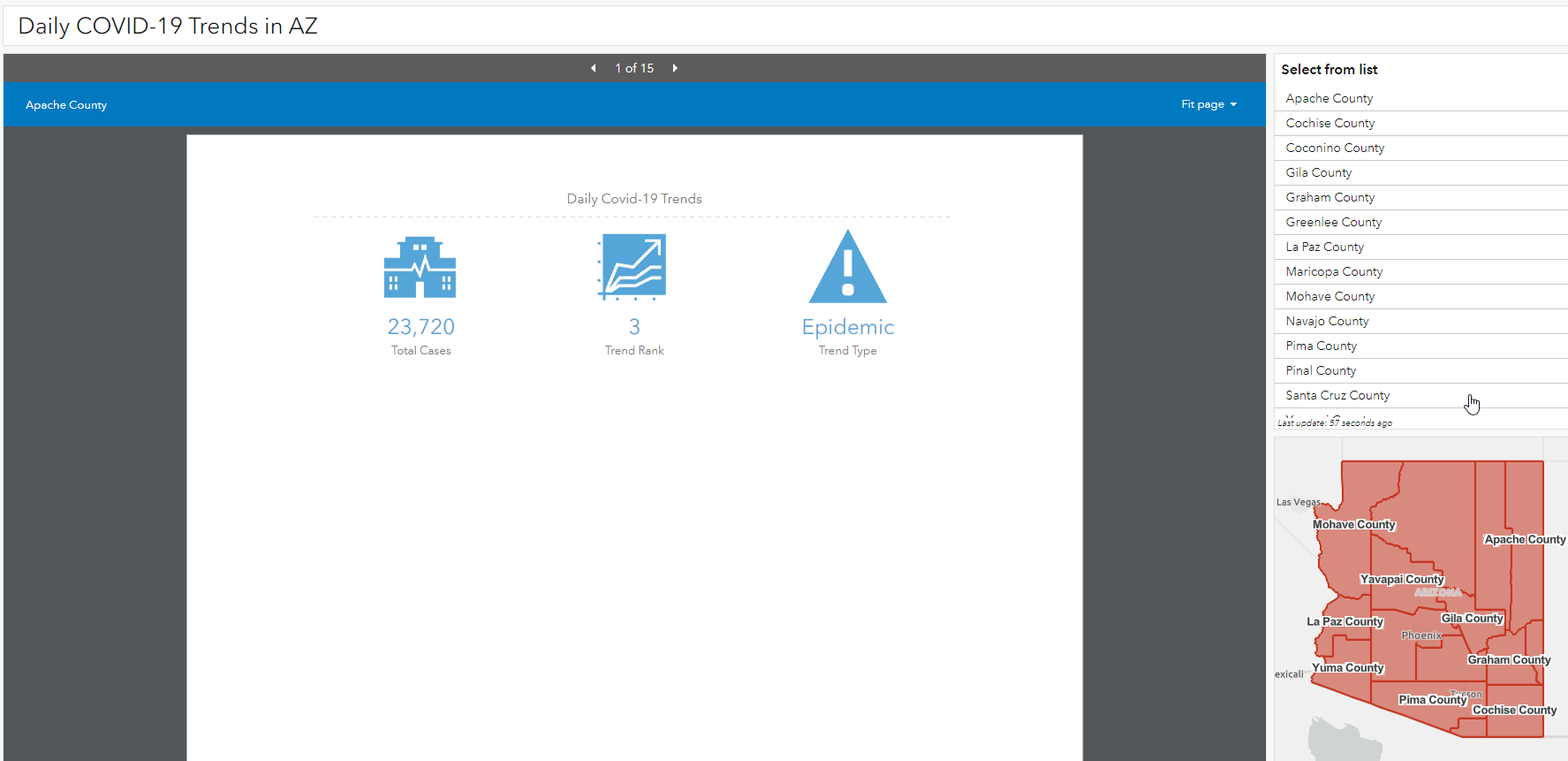

13. Add a title to the dashboard and click Create.
14. Open the dashboard app when ready. The embedded infographics will dynamically update for each county when the data is updated daily from the data source. This is a great feature to have since your audience will see the latest daily data whenever they access the dashboard application.
