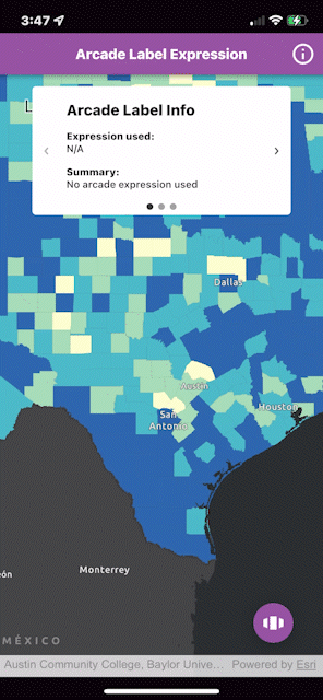

Feature Labels
Feature labeling is the process of dynamically providing descriptive text for features on a map or scene which are derived from the feature’s attributes themselves. With Arcade expressions, you can give your labels extra styling based on certain logic. The new Arcade Expressions sample provides an example of this as seen below. In this sample, you can rotate through the label expressions to dynamically see the labels update on the map. By default, it starts without any expression used, then will display total populations or total populations per square mile.

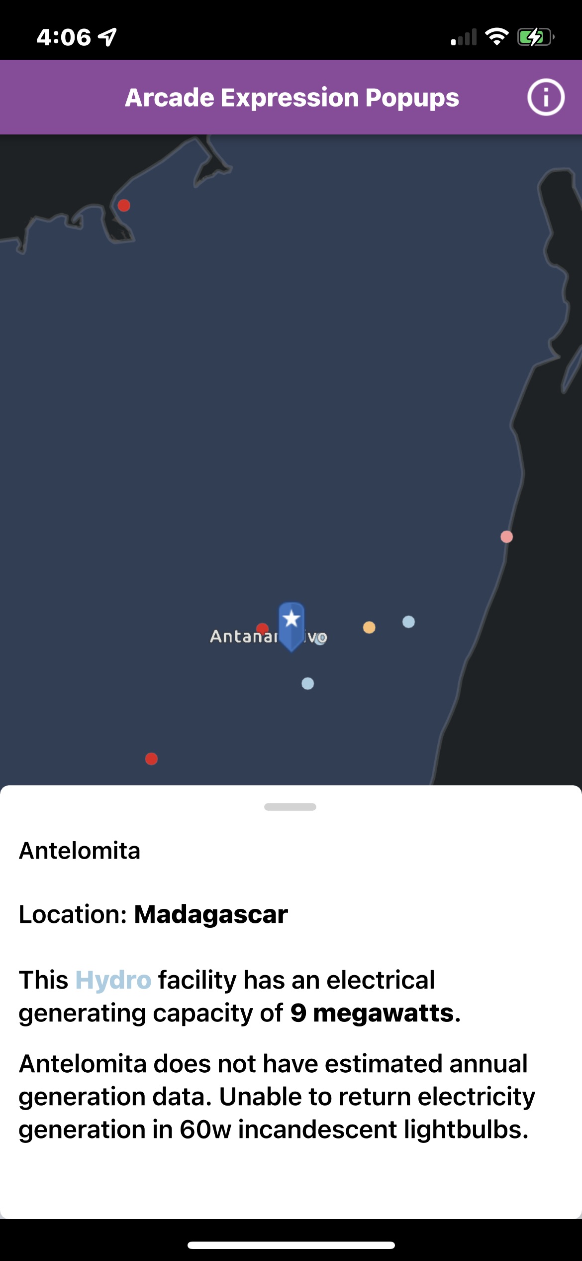

Popups
A popup is a pane that displays an identified features’ field attributes. In ArcGIS Online, you can configure popups using Arcade expressions to display customized text with styling. The text can be derived directly from field values or can use logic and calculations to display custom strings. You can follow this ArcGIS Learn Lesson that demonstrates how to do this. Once this popup is configured, AppStudio can pull that web map containing the layer with the configured popup as HTML text which can then be displayed in a pane on your mobile app. The example below demonstrates an AppStudio app that displays a configured popup from the above mentioned learn lesson.
This new sample demonstrates just two ways Arcade expressions can be used in AppStudio apps. Some other areas Arcade expressions are used are geotrigger notifications and feature attribute display field manipulation.
