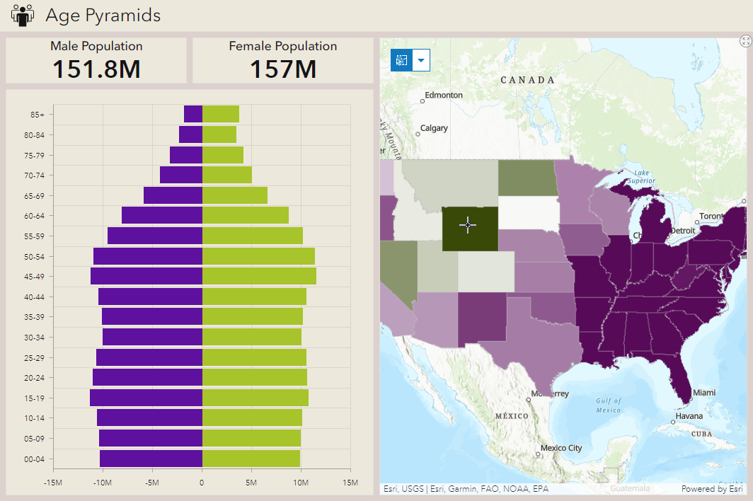

Here is a picture of the end result:

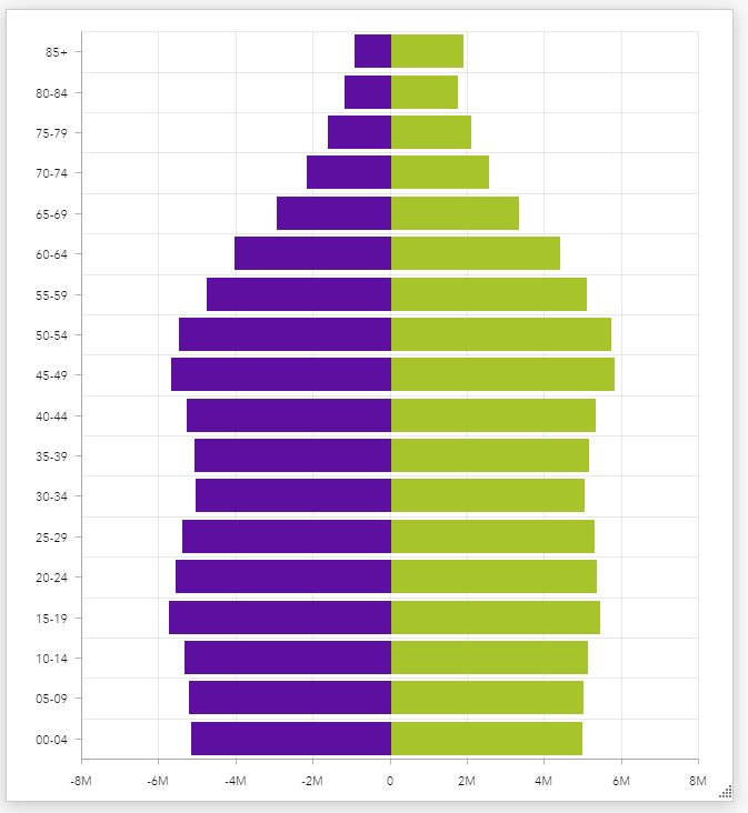

Now for the easy part! Configure your chart as follows.
- On the Data tab:
- Set to Grouped values
- Category field Age Range
- Split by field Gender
- Statistic Sum
- Field Population
- Sort by Age Range descending
- On the Chart tab, set Orientation to Horizontal
- On the Series tab, set Stacking to Stacked
Tweak whatever else you want to make the thing look nice, but that's it! You have an age pyramid chart!
If you noticed, we included the GEOID10 field in the expression, which means a map of the state features can be used to filter this chart, making it both super cool and also dynamic!
You can see the dashboard right here. If you like it, copy it!
