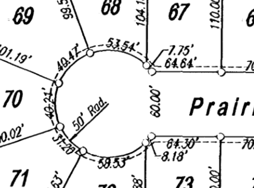

For instance, I continue to come across a situation where I have a cul-de-sac that has lot lines intersecting it along the curve. The plat indicates that all distances on curves are listed as chord lengths rather than arc lengths. No curve data or chord bearings are available on the plat.

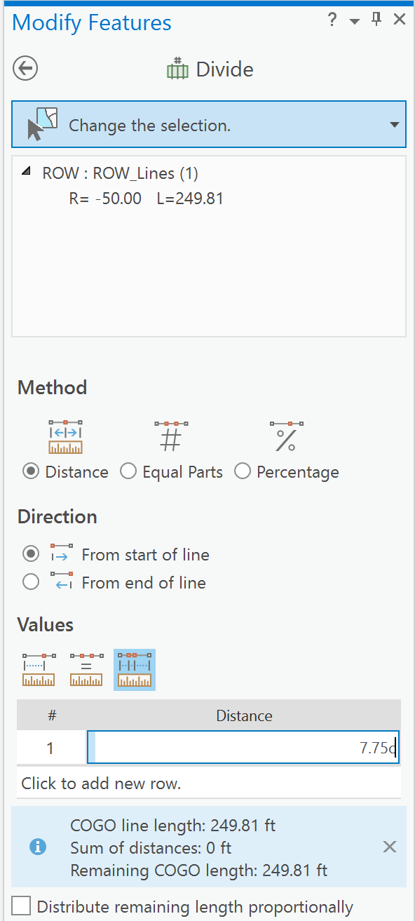

Normally, if I have arc lengths I would use the Divide tool to split the curve at my lot boundaries. In this situation I can't do that since I can't use chord lengths in the Divide tool.
I asked about this in a questions post and originally we tried entering the chord distances and then distribute the remaining length proportionally, but as we discovered the arc-to-chord distance isn't a linear ratio so this doesn't work unless all chords are the same length.
I can do the math manually to convert the chord lengths to arc lengths but my suggestion is that COGO aware tools should be able to accept overrides and do that heavy lifting for us! 🙂
As an example I would like to be able to enter the chord distances in the tool below by typing 7.75c, 53.54c, etc. and since the tool is COGO aware it would do the math and convert to arc lengths like it does in the Traverse tool.
