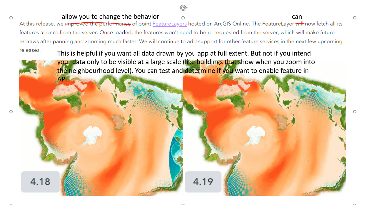

Once ESRI fixes the behavior to make it opt-in, they can reword the release notes like this:
