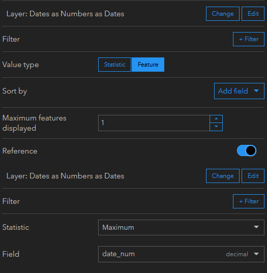

I've got my indicator looking at the data expression, and it's set to Feature. I also have a reference value set, and that's looking at the Maximum date number of the same expression. I'm also limiting it to a single feature.

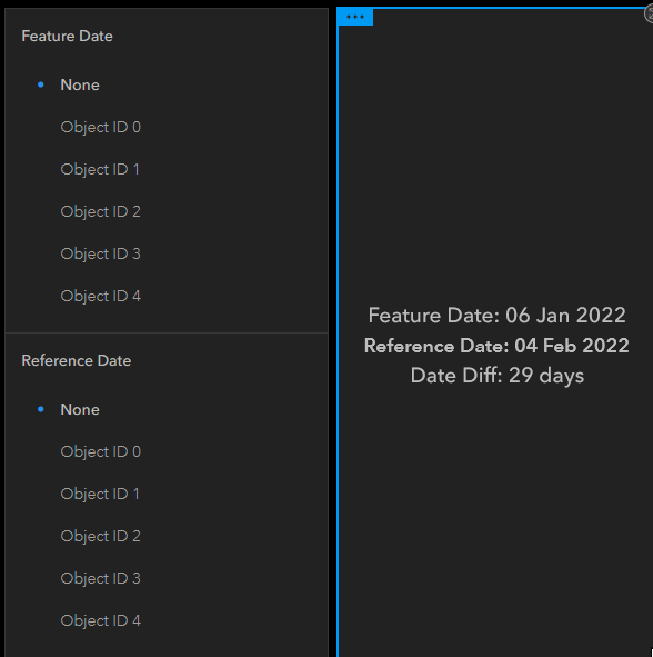

I've got two selectors set up. One targets the indicator value, one targets the reference. Both are based on the features in the expression.

And that should do it!
