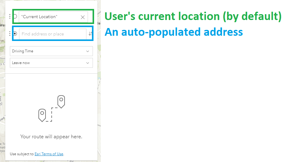

Hello,
Using the Directions widget I would like to:
i.e.:
Unfortunately, I have not found properties in the documentation to do this.
Any help would be greatly appreciated.
Thank you
Hi @ZA1, unfortunately it is not currently possible to pre-populate the Directions widget with two different addresses or locations. However, we have some enhancements coming that might make this possible at a future release.
If you don't need the Directions widget, you could handle the routing and the turn-by-turn directions yourself using route: https://developers.arcgis.com/javascript/latest/api-reference/esri-rest-route.html
