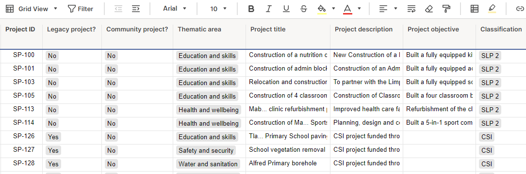

The screenshot below is a sample Smartsheet data.

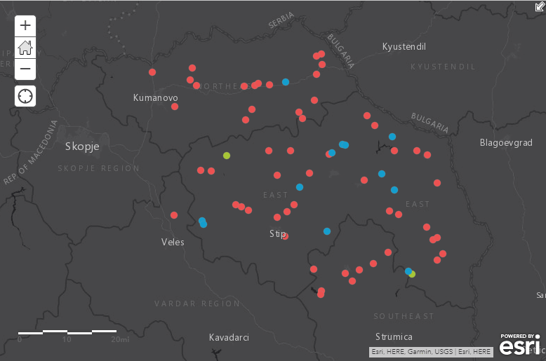

The following screenshot is the feature layer that has already been published as a hosted feature layer from the Smartsheet into AGOL before and after updates. As such both the hosted feature layer and the Smartsheet have the same schema and fields. This Smartsheet gets updated on a weekly basis. Therefore the hosted feature layer needs to be updated as well to reflect the updates on the web map. Using ArcGIS API for Python, this process can be automated.

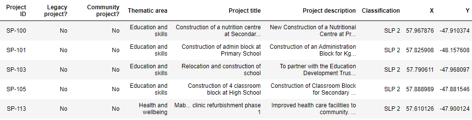

The rows with no latitudes or longitudes are removed.
Note that X and Y columns are the longitude and latitude coordinates respectively.

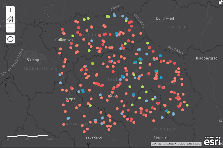

Now the hosted feature layer updated with the Smartsheet is displayed in the web map.
