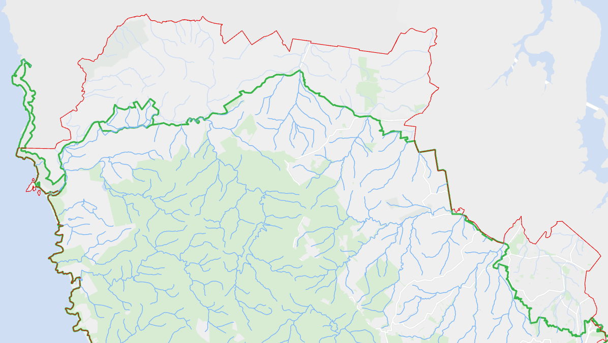

I would like to cut out a shape from the negative space within a feature area to create another feature. Eg. below are 2 feature layers the red outline is a polygon sitting underneath another polygon which is the green outline I would like to create a feature layer polygon from the red line to the green line. I have no idea how to do this and would greatly appreciate any advice.
Thanks in advance
https://pro.arcgis.com/en/pro-app/latest/tool-reference/analysis/erase.htm
Input Feature - Red polygon
Erase Feature - Green polygon
Thank you so much @DavidPike . I had looked at the Erase tool but hadn't quite figured it out. I knew it would be simple 🙂
