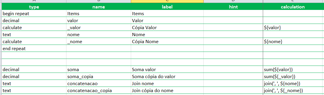

I'd like to report a bug on calculates within repeats of web forms.
The calculate fields from the first inserted item are alwaysupdated accordingly the last modified item, causing wrongcalculation values being sent to the data store.

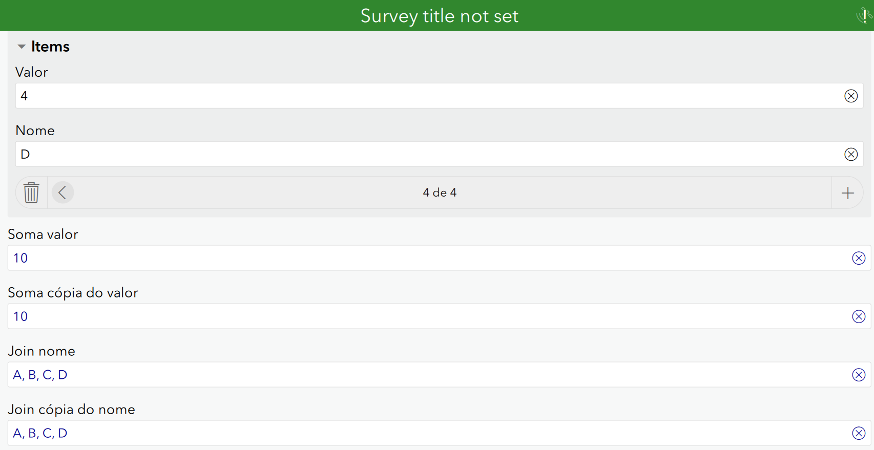

The same problem doesn't happen with the field app.
Form:
Behaviour on the web:
Error web form
Behaviour on field app:
