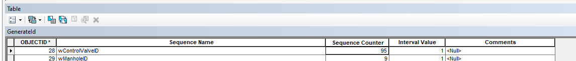

I am trying to generate unique ids with the Attribute Assistant in ArcMap 10.6 for several features in our water and waste water system. I was able to successfully do this with features that did not contain any subtypes; not so much with features that did have Subtypes. I have not been receiving any error messages but I also am not seeing anything appear in the AssetID field. For the example below I am trying to generate unique id for the feature wControlValve
GenerateID table
Sequence Name: wControlValveID
Sequence Counter: 95
Interval Value: 1

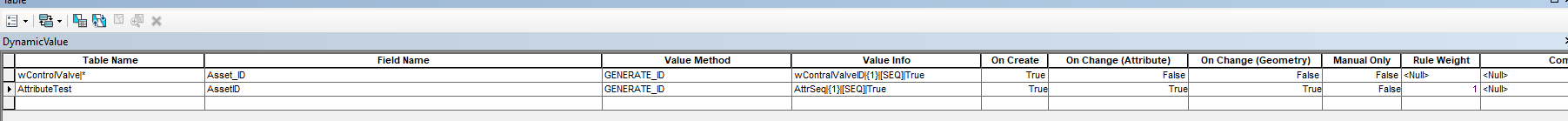

Dynamic Value Table
Table name: wControlValve|*
Field Name: Asset_ID
Value Method: GENERATE_ID
ValueInfo: wContralValveID|{1}|[SEQ]|True
On Create: True
