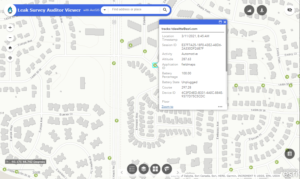

What if the technician had a mobile phone or tablet with the ArcGIS Field Maps app installed? Then with the ArcGIS Tracking capability that is now built into the ArcGIS Field Maps mobile application, the software could be documenting every few seconds the location, date/time, and username of the field technician. The technician no longer needs to stop to mark or denote what portion of the pipe system was just traversed. Keeping the technician moving, improves efficiency and reduces costs.

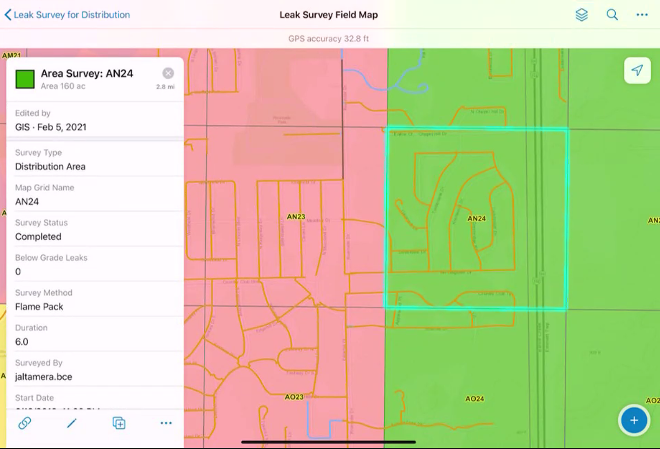

Today’s smart devices are amazing little computing devices. With the ArcGIS Field Maps mobile application, these smart devices know who I am, where I am, and the local date and time. This system knowledge when applied to Leak Survey improves the efficiency of the field technician. The recent enhancement of Attribute Rules to ArcGIS allows for this this information to be automatically written to the Leak Survey record.
Why ask the field technician to stop moving and spend time documenting what the ArcGIS Field Maps application on the smart device already knows?
No longer does the field technician need to enter the date and time when they started the leak survey area. The ArcGIS Field Maps application knows this time. When the user changes the leak survey status to: In Progress, the application automatically populates the start date and time to the leak survey record. Nor does the field technician need to enter the date and time when the leak survey area is completed. The application knows this time, which is when the user denotes the leak survey status as: Completed. The application also automatically documents to the leak survey record the username of the field technician when the survey status is completed.
Being able to leverage the smarts of the smart device allows the field technician to keep moving, and complete the Leak Survey in less time.

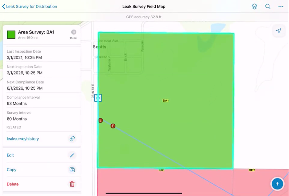

4 - Streamline IT Data Administration
Another cost that is often overlooked is the cost the IT department will incur maintaining this compliance information. Many legacy solutions required extensive effort and cost to prepare the information for the next Leak Survey interval. This may be the cost to print thousands of paper maps which will be used by the leak survey field technicians. It may also be the cost to prepare the data in a digital leak survey system.
Applying the attribute rule capabilities of ArcGIS to this problem has nearly eliminated the need for prepping of the information.
With the current capabilities of ArcGIS, the updating of the next inspection date and next compliance dates are performed immediately by the software when the leak survey area is designated as completed. No longer is this a post-processing task for IT to initiate and monitor.

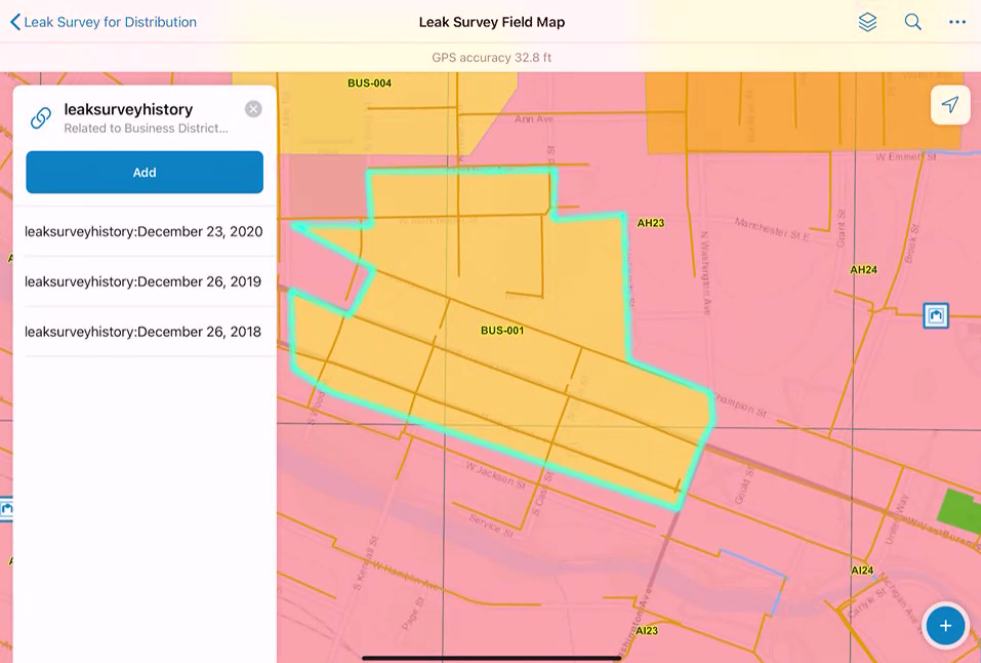

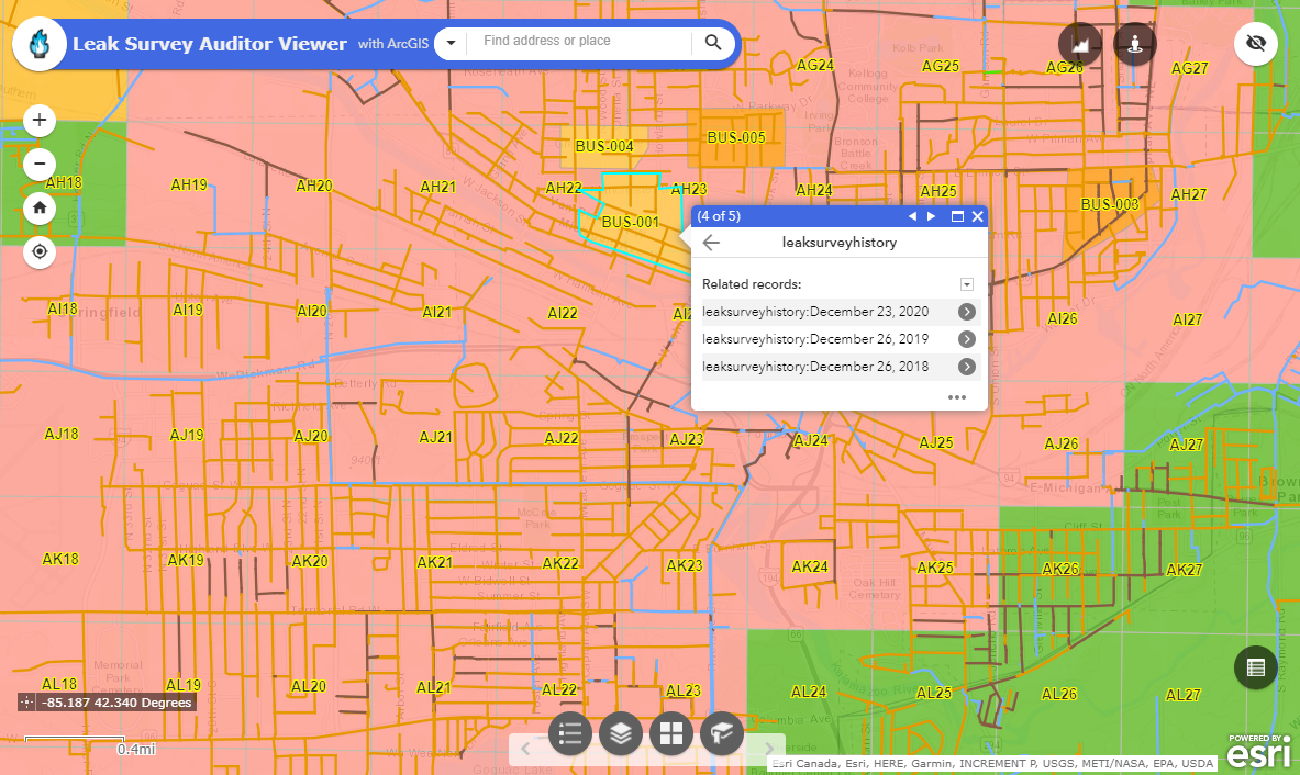

5 - Improve Management of Leak Survey History
A key part of minimizing the cost of IT administration of leak survey is the elimination of the need to archive the leak survey data for future regulatory audits. Gone are the days of the GIS or IT administrator working on New Year’s Eve to copy out the current year’s leak survey data and reset the leak survey areas in preparation for next year.
Now, a leak survey record is immediately archived to the Leak Survey History table as soon as the status is set to: Completed. Applying better management methods to the leak survey history, not only reduces administration costs, it also provides easier and more intuitive access to a leak survey’s history during a regulatory audit.
