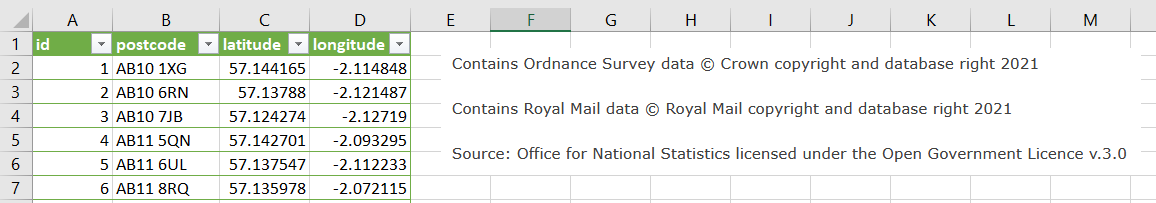

For the purpose of this article, I downloaded postcodes from FreeMapTools.com . I found the data in freemaptools.com good enough: The .csv file I downloaded was last updated on March 19, 2021 and had more than 1.7 million records, each with its own latitude and longitude. More than 60Mb worth of data. Microsoft Excel could not open the file entirely, but here is a screenshot of its contents:

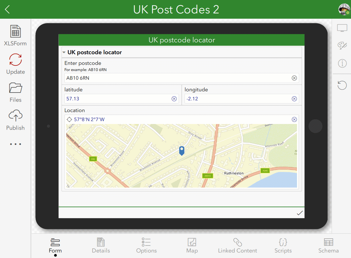

At a high level, what we want to provide to the end user is a way to enter a postcode in the smart form, and automatically calculate the location of that postcode. The following screenshot shows a basic starting point: The user defines a postcode and we center the map. Simple!
To do the above, we first need to somehow retrieve the latitude and longitude of the entered postcode, and then construct the geometry so we can set the value of the geopoint question to center the map. How you perform the lookup search against that 1.7 million record table is a key decision. Lets explore a couple of methods, and describe when you should use one, or the other.

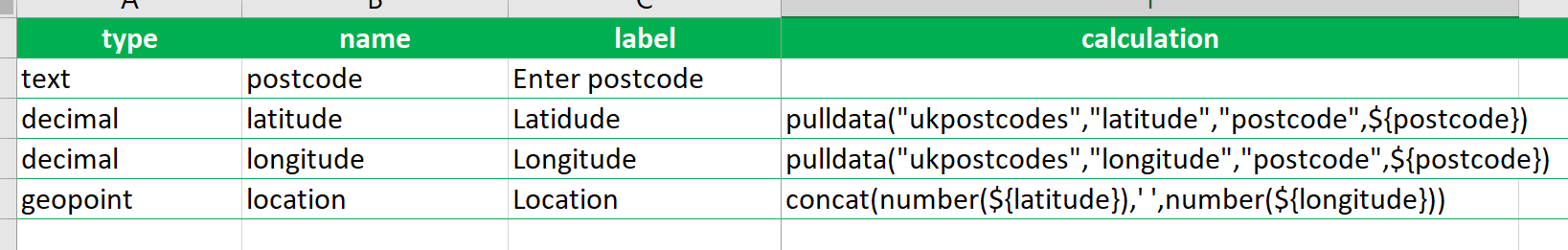

To bundle your Survey123 smart form with a local .csv file, you need to copy it into the survey's media folder. The following image shows what the XLSForm design would look like:
The first question is used to let the user enter a valid postcode. The latitude an longitude questions use the pulldata() function to retrieve the coordinates of the postcode by searching the ukpostcodes csv file. This is the file I downloaded from FreeMapTools.com and then copied into the media folder of my survey. Finally, the geopoint is constructed using the latitude and longitude retrieved.

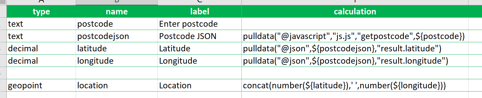

As an alternative, we can use a custom JavaScript function to perform a live query against a web service to retrieve the latitude and longitude values. Since we are working with an online form, it is assumed that having connectivity is not an issue. Here is what the XLSForm could look like:
In this case, we are using two variations of the pulldata() function. We are no longer using it to search a value in a .csv file. Instead, we use it to run a JavaScript function first, and then to parse the contents of a JSON object returned from the JavaScript function.
If you are not familiar with the use of custom JavaScript functions in Survey123 smart forms, check this Tricks of the Trade blog. In our scenario, my custom JavaScript function is making a request to the Lookup a postcode operation of https://postcodes.io/ This operation returns a JSON object with quite a bit of information about the postcode, which is later parsed to extract the latitude and longitude.

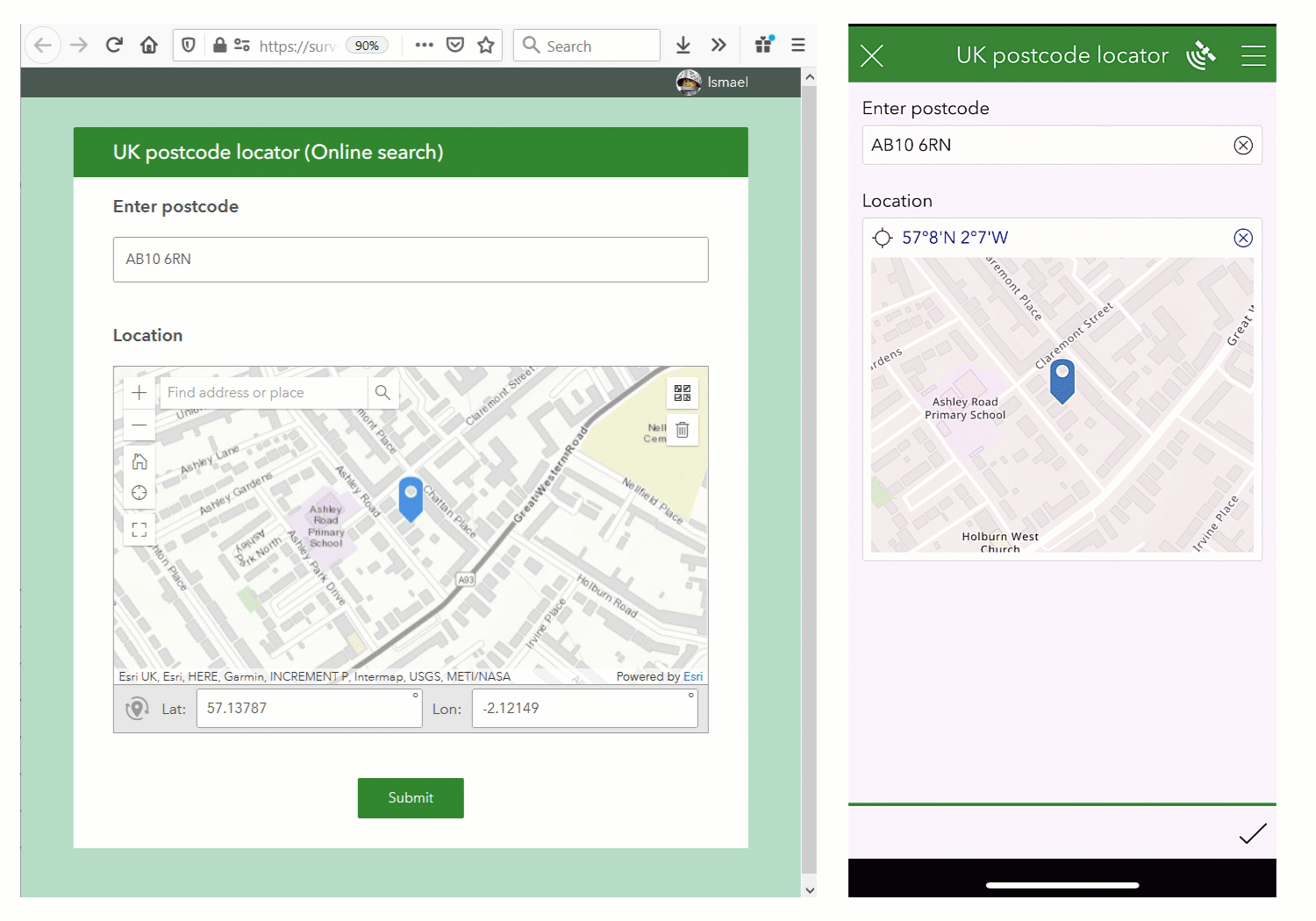

The use of a custom JavaScript function here helps us keep the form lightweight. We no longer need to bundle it, or link it, to a .csv file. Another great advantage is that we do not have to refresh any tables. As long as the web service is up to date, our smart form will get the latest information. Here you can see the web and field apps side by side running our UK postcode locator.
