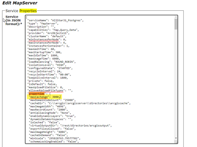

12) Consider Increasing Service MaxCacheAge

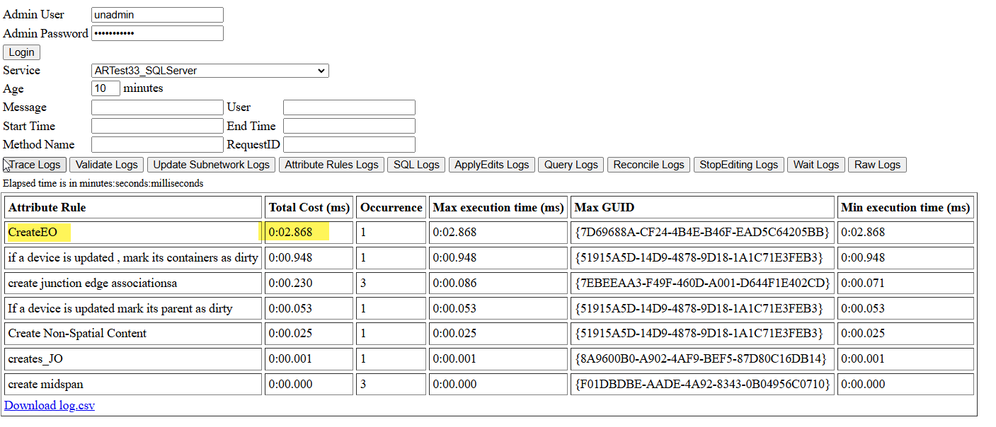

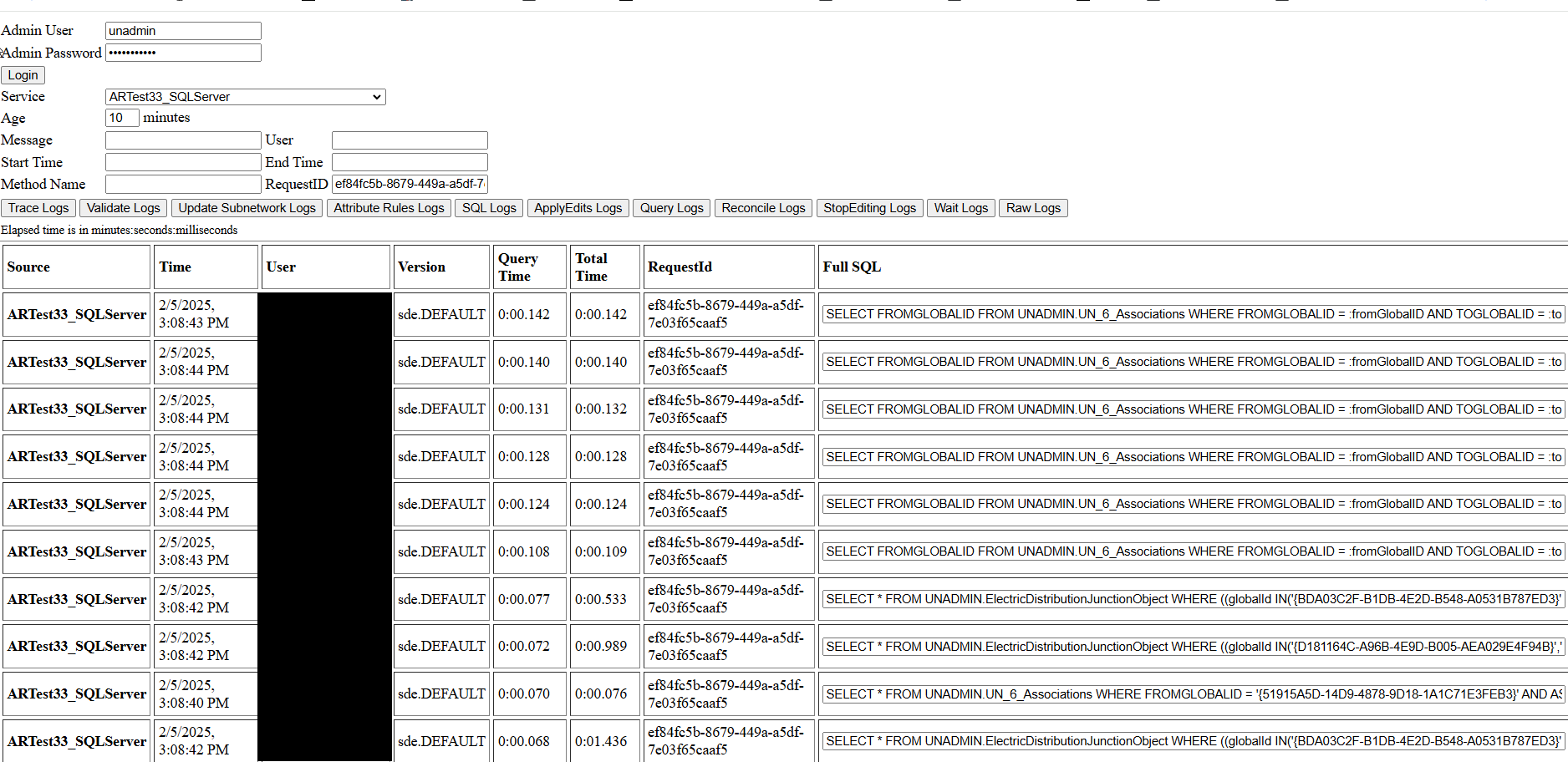

18) Debug Attribute Rules
19) Identify Slow Attribute Rules with uncli

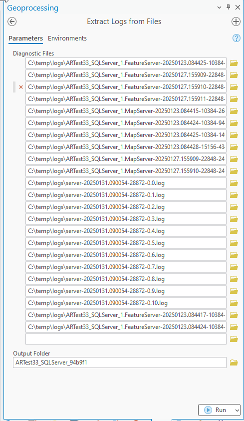

20) Attribute Rules Log extractor
The map service creates a per SOC cache for the data sources opened for each edited version. For example, if an edit is received on a version A, the workspace is opened a cached for version A on the SOC that services the edit. The next edit on version A will utilize this cache if it happens to hit the same SOC.
The MaxCacheAge controls how long the data sources cache should remain on the SOC before it is discarded. Increasing that value (default 5 minutes) raises the chances of cache hits and improves overall performance but at a cost of higher memory usage for ArcSOC.
You can add maxCacheAge using the admin API, right under the properties of the mapserver of your service. The value is not there by default.
When debug logging is enabled you will see a broadcast entry showing how many classes and tables are opened. This tells us how long the broadcast took, and how many tables/classes and relationships were touched. For example if there is a feature dataset with 100 classes, and we published one of those classes as a service, all 100 will be opened when you edit that class.
BeginBroadcastStopEditing;Broadcasting Stop editing accross: 1 Feature Datasets, 24 Tables, 17 Relationships

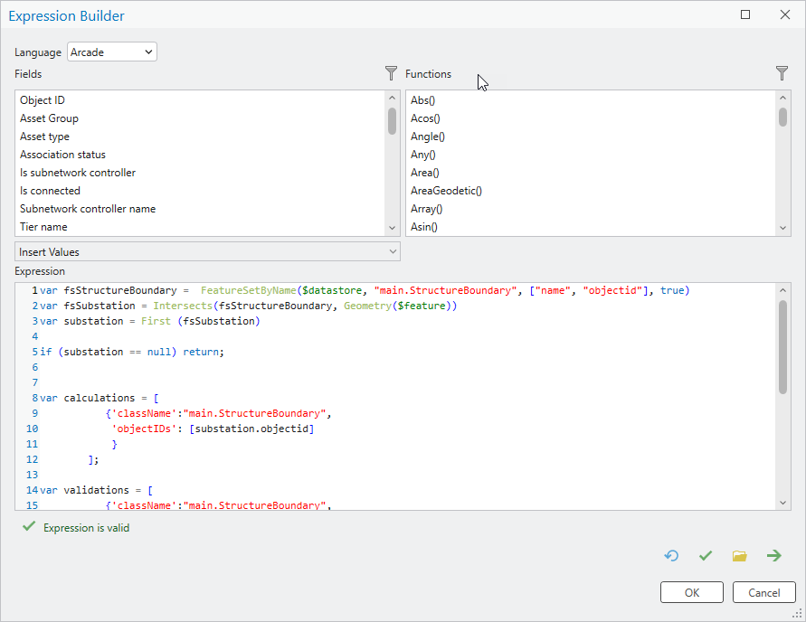

14) Understand Attribute Rules validation
The Attribute Rule expression builder allows users to author Arcade expressions and validate them based on the attribute rules profile context. However, Attribute rules work with Arcade globals that are tied to editing context. For example when you edit a feature the $feature global is populated with the current state of the row being edited, another example is the $originalFeature is the state of the row before the edit which is applicable for update events.
These globals are not available during validation of the expression, so what the builder does is the fetch the first row in the table and use it as input to $feature. That $feature is then used for validation of the script.
This results in interesting scenarios where the rule can pass validation but fails at runtime. That is why the Arcade script author should always author guard logic to protect against all cases. Let us take an example
//This script validates fine in the expression builder
//but fails when a new feature is created
var label = $feature.labeltext;
//split the string based on a space
var lblArray = Split(label, " ")
//take the second token
var secondPart = lblArray [1]
return secondPart;
Arcade is a programming language that needs to be authored to handle errors. In this particular case the first feature in the table, which is used by the expression builder for verification, happened to have a whitespace in $feature.labeltext which passed the validation. However when subsequent new features that are created may have a location without a whitespace, which results in a split returning 1 element instead of 2. This is why the rule sometimes work and sometimes fails with index out of bound error.
Here is the updated rule with the fix to exit if the script has not space.

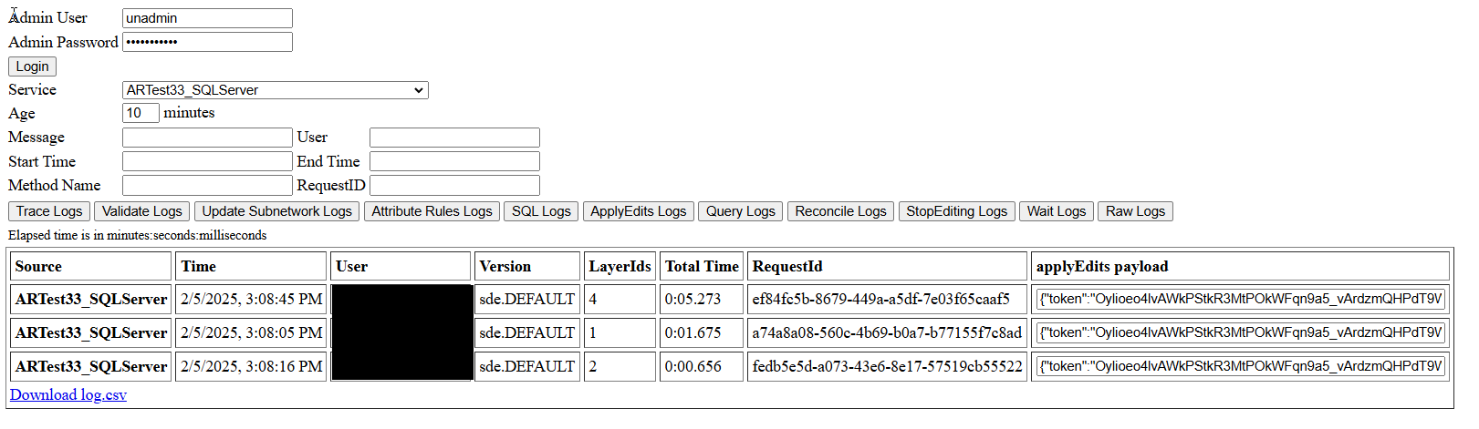

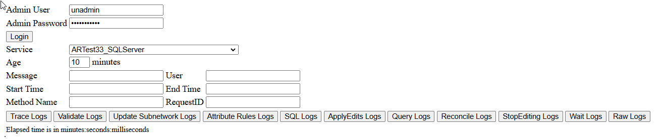

This server log parser is a web tool that uses the admin API to query and parse recent logs. It can show Utility network Trace, Validate, update subnetworks, it also show the summary of attribute rules and how long each took and the SQL queries executed as a result.
You can install uncli server log web parser here. Make sure to install it on the same machine as your webadaptor. Once you install and configure it it will look something like this.
https://webadaptorurl/log
Let us say we have a slow edit that we want to debug. First we enable server log debug mode in order to capture attribute rules.
Then we make the edit in Pro or the Web Editor.
Next we go to the web parser, login using the admin credentials and select the service we want to extract the log from, how long ago we want to query (10 minutes is the default) and click on Attribute Rules log. This will query the admin api for all attribute rules that has been executed in the past 10 minutes and list them as a table.
We see that the slowest attribute rule is CreateEO (edge object) and that took almost 3 seconds. So we go and investigate why the rule is slow based on the topics we learned in this article.
We can use the applyEdits log to see the raw edit and how long it took.
Taking the request Id which is the unique identifier for the request we can use it to subsequently filter all queries executed by that request. In the requestId field fill in the request id from the applyEdit and click on SQL logs.
In this particular case, there is no one particular query but a lot of them that add up.

The uncli log extractor is great against immediate edits that happen recently, but it requires configuration, admin api access but it is not designed to work with large amount of logs (ie, days or weeks). For that the solutions team have a dedicated log extractor tool that takes the raw xml files and turn it into indexable mobile geodatabase.

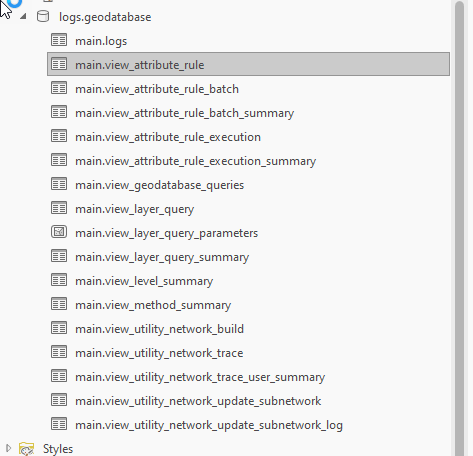

Download the Utility Data Management Support toolbox from here.
Add the toolbox to pro and run the Extract Logs from Files tool.
Drag the ArcGIS Server logs and ArcGIS Services Log to the diagnostic files. The logs can be find under the arcgis logs directory.

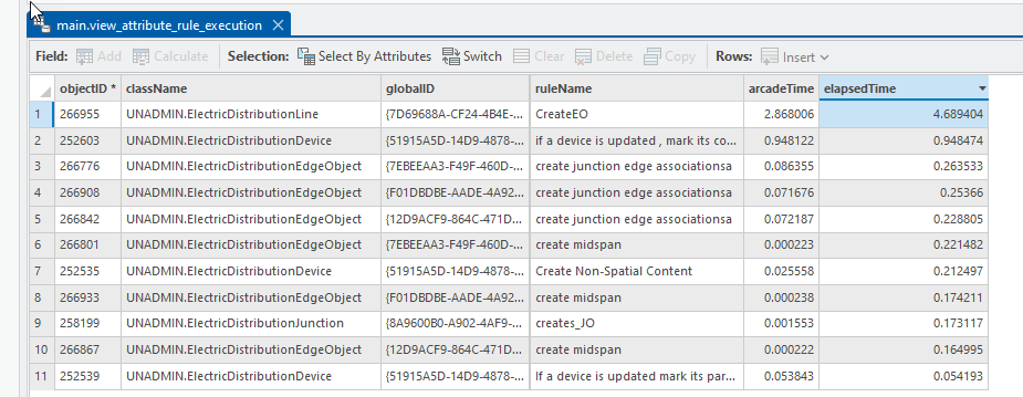

The output is a mobile geodatabase, let us add it to Pro. The main.logs table has all the events, the rest are views that summarizes the log.
Let us open the attribute rules view and sort by elapsedTime to find the slowest rule.
the geodatabase queries view shows all the SQL queries executed, just like we did in web parser, we can use the requestid to filter the SQL for a specific requestid.
