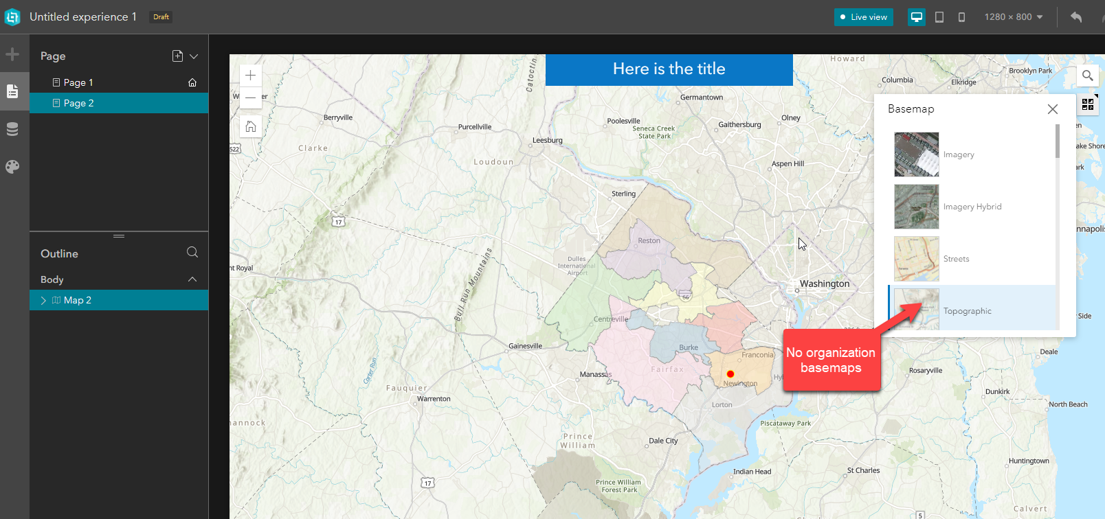

I've enabled the basemap tool for a web map widget but our organizations basemaps don't show up as choices. I have a basemap group configured for our organization and other web maps/apps show my custom basemaps without issue. I'm seeing this in 10.8.1 portal but not AGO.

I experienced the same using ExB Dev Edition against Enterprise. I worked around it by creating my own basemap widget which will only pull in the organisation basemaps. Code attached if anyone wants it, it s basically the JS API basemap widget with a call to get the organisation basemaps, have not tested it against AGOL.
