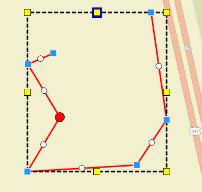

It seems the geometry editing portions of the .NET Runtime SDK's Editor are not very well thought out, especially for touch or stylus use. Say we're editing a line:
The good:
- Blue squares for vertex movement
- White circles to add vertexes - very handy
The bad:
- None of the yellow boxes are useful and tend to get in the way
- No user will ever think the large blue box is for rotating the shape, and it is covered by a yellow box, rendering it very hard to use for all modes of input
- Moving the shape is possible, but really hard to do for a line. For, you have to grab the line precisely (and it is pixel perfect). If you concentrate, you can grab it with a stylus. Touch input is a no-go.
