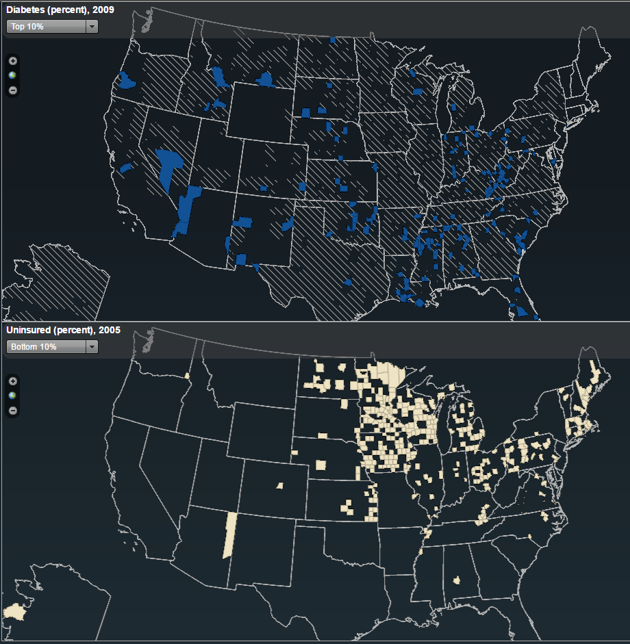

Quite some time ago, I built a healthcare-oriented Flex app. It let you choose two to four attributes and set a numeric filtering criterion on each, using the drop-down control.
Then the Summary Map button would produce a filtered map with the unioned results of those filters—like a logical "AND" operation. This facilitates exploration of your data set, helping you find, for example, places where diabetes rates are above average and also where uninsured rates are below average.

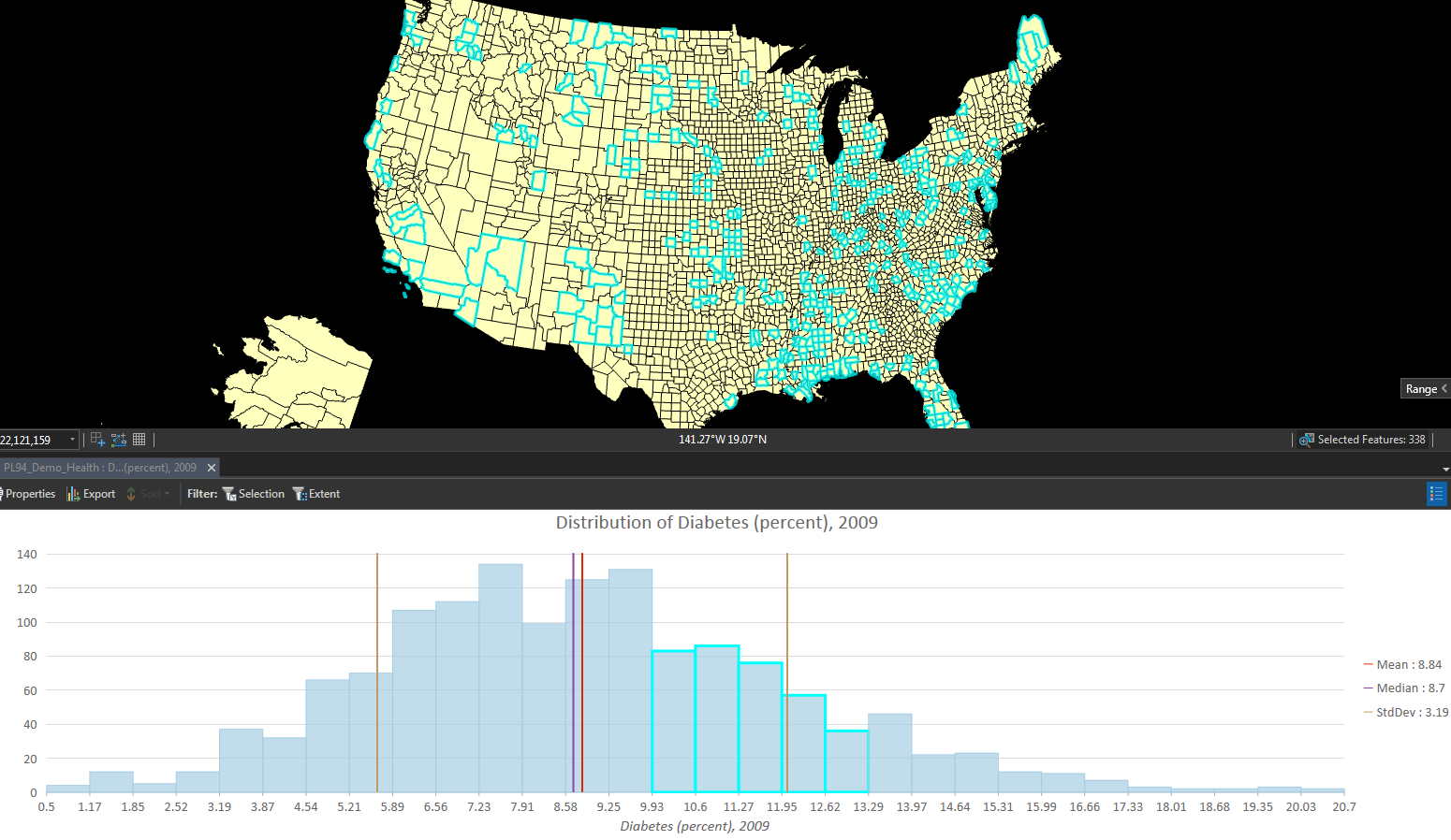

Some searching indicated that all this desired functionality is already available in different places in ArcGIS Pro. A Histogram chart shows the mean and median and a histogram of how the data is distributed throughout its range. There are some pretty neat features here that mirror chart selections on the map and vice-versa. If you create ranges for one or more attributes, you can use the resulting range slider bars to define, apply, and combine filter criteria.

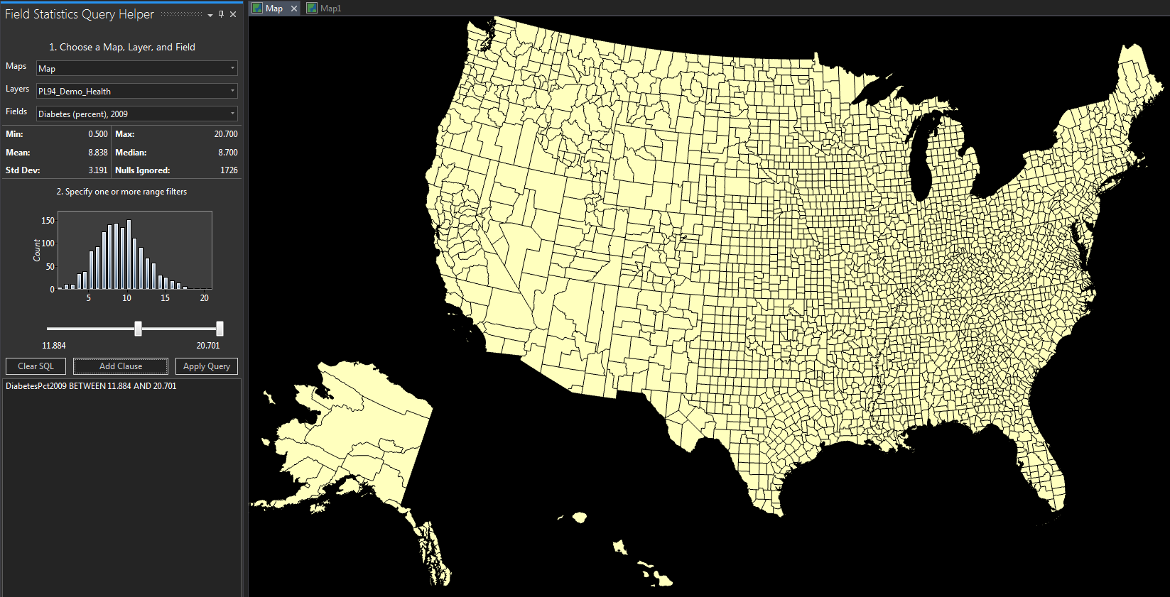

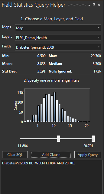

- Click the "Query Helper" button in the add-ins tab.
- Select a map, layer, and field; use the track bar control to choose a range of values in that attribute.
- Click "Add Clause" and then "Apply Query" to filter the features on the map.
- You can add more fields and ranges to the SQL and apply them for an additive effect.
- You can also edit the SQL where clause in the text box if you want to explore your data more directly; if you enter an invalid SQL clause, the map result will be blank--just click Clear SQL and start again.

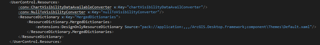

XAML design mode
I also needed a way to hide the statistics field and histogram when an attribute field wasn't yet chosen and there was no data to display. I did this with a ValueConverter. The suggested way to declare ValueConverters is as static resources in the XAML file; unfortunately, this led to another problem I still don't have a proper fix for. The resource declarations seem to confuse the visual editor into displaying only an error message. My workaround was to remove the static resource declarations for those rare occasions I wanted to use the design view; then pasting those declarations back in before building the project.
