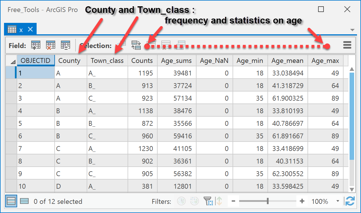

Example of Frequency and Statistics
If you had 4 counties with 4 towns of various size classes and you were interested in studying age dynamics versus population size, you might want to start with that basic premise.
- Classify/group/categorize the towns by population size
- Produce a unique classification scheme or use 2 or more existing fields to group your data for counting (aka, frequency).
- Now, that the data are grouped, you can now determine some basic statistics for those classes.
Output example
See the table as an example... A table is as good as a map and you don't get distracted by all those colors.
So, row 1, County A, Town_class A_.... 1195 people, some stats... Age_min will not be below 18... pretend, survey privacy.
A little Chi-Square, perhaps a Moran's (if we wanted to map) and off you go.
Sadly this is in an Advanced license. The whole production of the classification scheme, the frequency determination and the sorting is basically 1 line of code. The stats stuff? python and numpy. Null values? handled with ease... besides you should never have nulls anyway.
