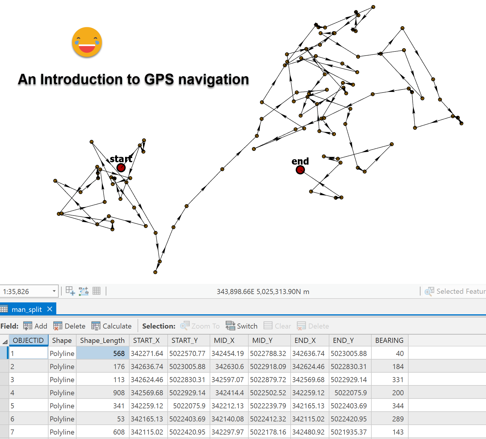

First a picture... given a location, you are instructed to move 100m in 10 degree increments between points. You will obviously track a circle. The traverse point locations can be constructed from base geometry. The locations can then be saved to a featureclass. The point featureclass can be converted to a continuous line, which can be segmented if you desire. Total time, not much.
The image above, shows the results of such a venture.
- I created my geometry using python/numpy
- I save the results to a featureclass using Numpyarraytofeatureclass (hence points)
- From those points I used Points to Line available at all license levels
- The continuous line was blown apart to segments using Split Lines at Vertices but alas, only available at the Advance level. .... ( I will save this obstruction to another blog, where I will show you how to do it with a standard license
EDIT... From the second incarnation, you can produce a featureclass and use the XY to Line tool which is available at all license levels) - Add Geometry Attributes enabled me to obtain the coordinates of the start, middle and end locations of the line. This could have been done during the construction of the geometry as well.
An how many of us have taught a class where this happens....
More to come....
