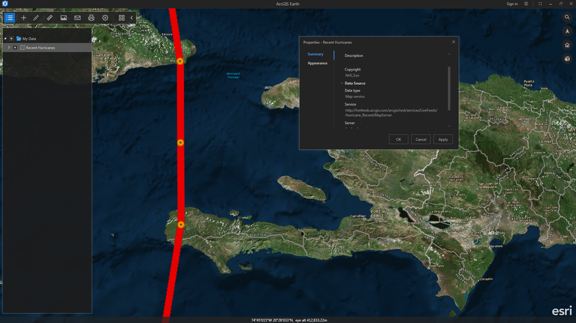

The picture below shows a 2D view of Hurricane Matthew’s path across Haiti, loaded into ArcGIS Earth from one of many publicly available sources of information on ArcGIS Online. (Simply right-click and select properties in the table of contents (TOC) to expose metadata for any dataset).

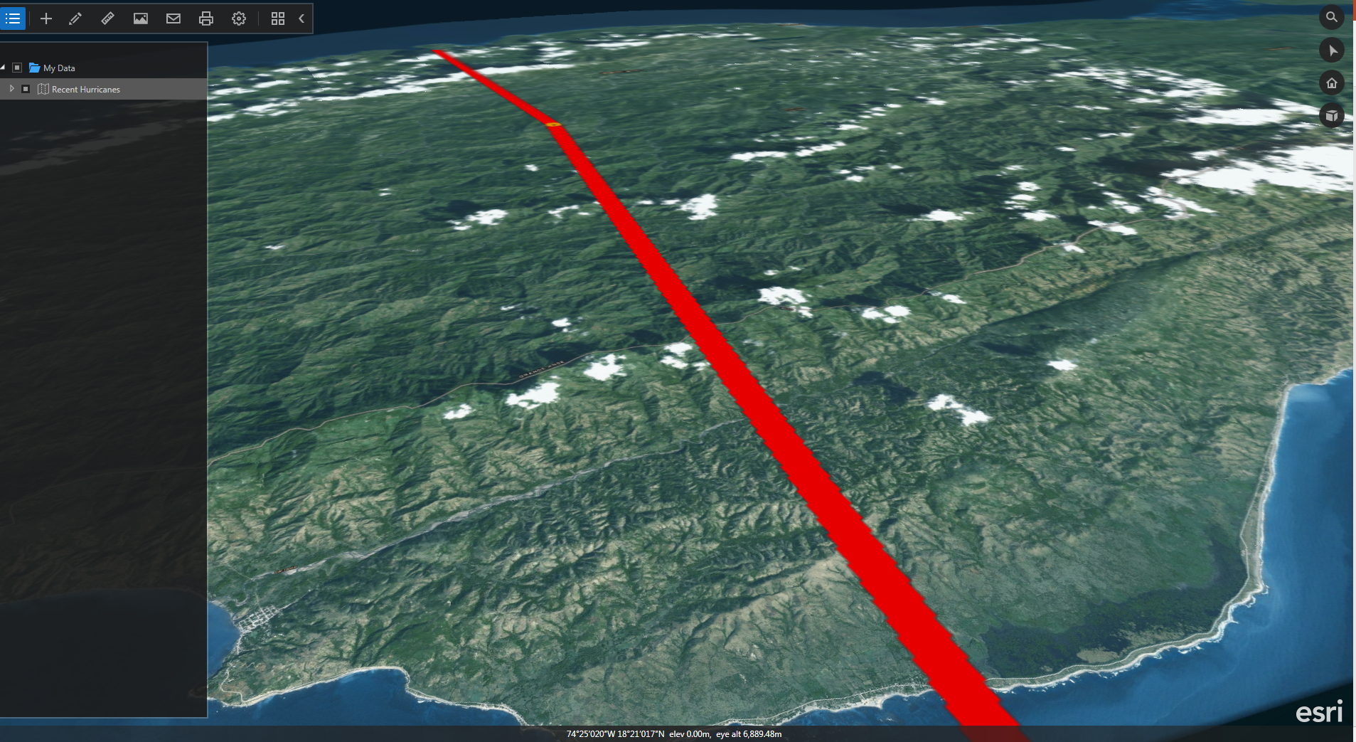

Hurricane Matthew devastated Haiti. The tropical cyclone crossed Haiti's western tip as a Category 4 storm and then traveled into Cuba and onto Florida and the Carolinas. Hurricanes are typically known to slow down or even change path when encountering land. Mountainous terrain can disrupt the center of circulation of the storm. Unfortunately, Haiti’s mountainous terrain was not enough to slow this powerful storm. Matthew’s track steered west, away from higher peaks like Massif de la Hotte (Enter ‘Massif de la Hotte’ into ArcGIS Earth’
s search locator to fly to the location) and over lower terrain. Zooming in and rotating the view, lets you appreciate this from a 3-Dimensional perspective. In the view below however, the mountain range looks almost flat and hardly discernible.

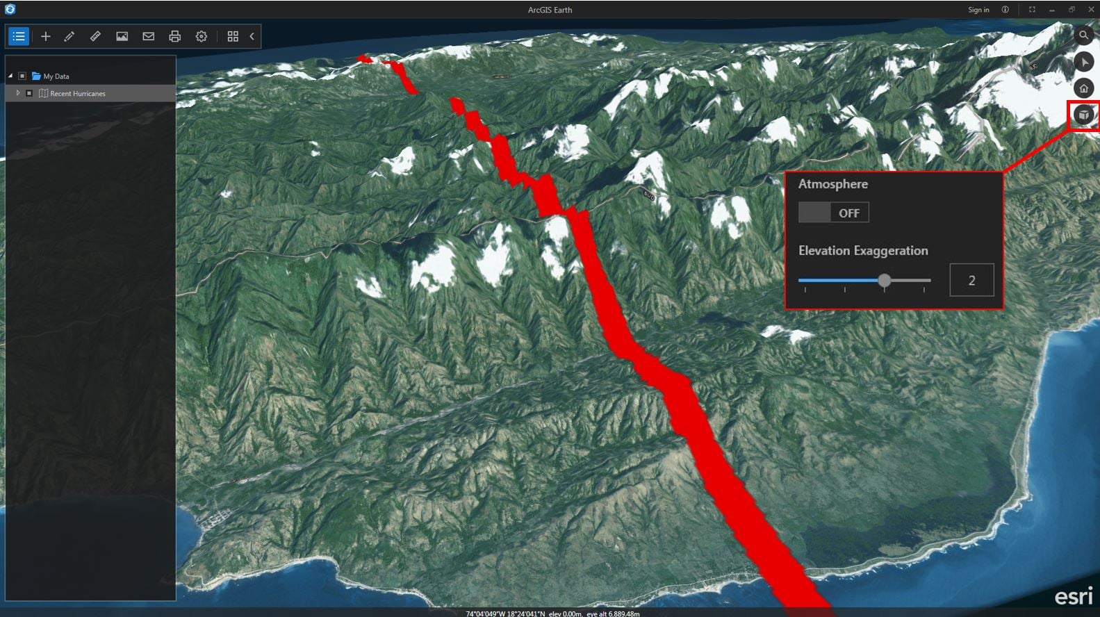

To better understand the terrain variation in Haiti, ArcGIS Earth’s VE tool is used to adjust the VE value to 2.0 in the image below, increasing the vertical heights of the mountains. The terrain is enhanced and this visibly changes the appearance of the topography. (Vertical exaggeration is calculated by dividing horizontal scale by vertical scale. In ArcGIS Eart#h the VE scale ranges in values from 0 to 3. A value of 0 renders all terrain in Earth at mean sea level.)

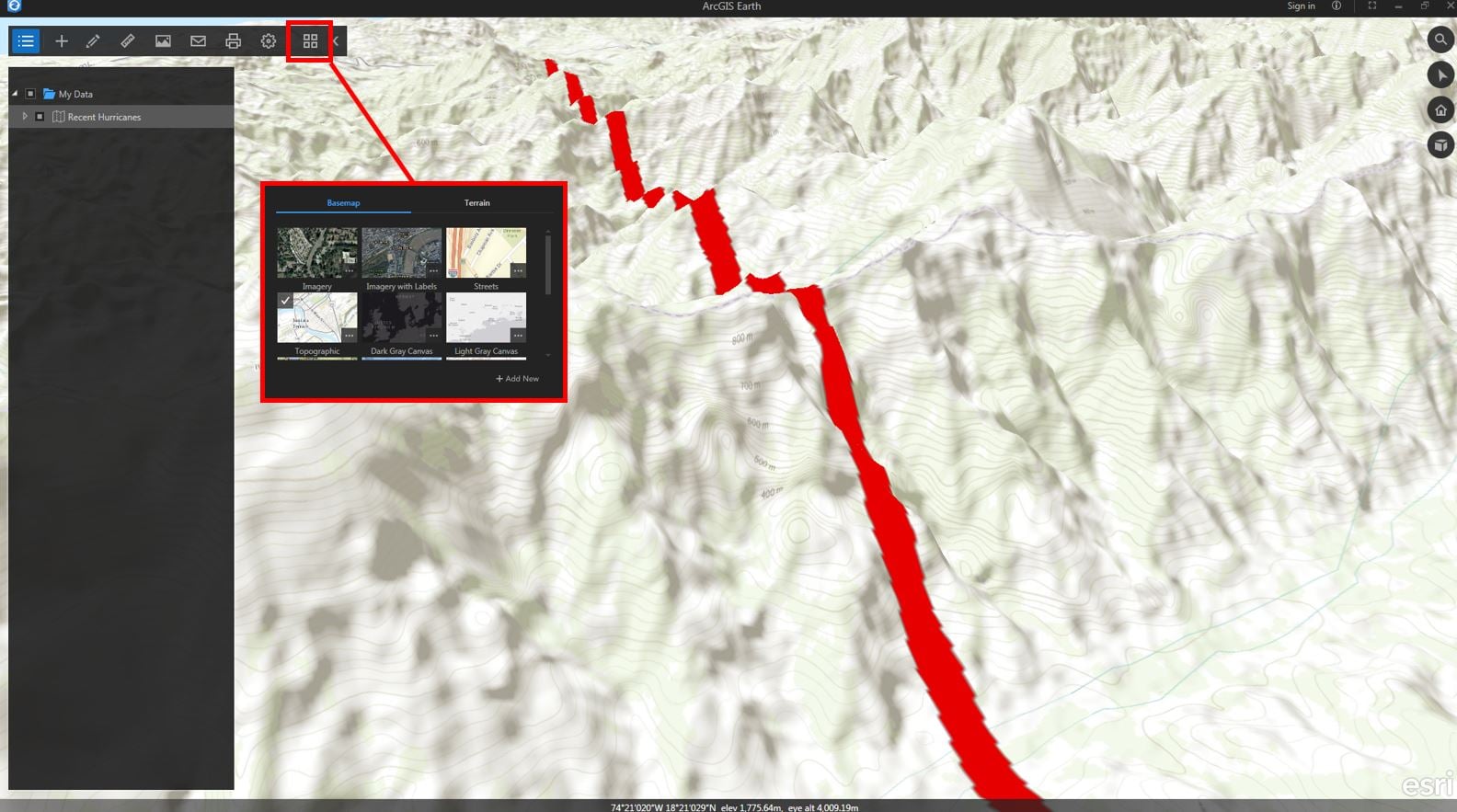

Matthew’s path is shown against the backdrop of the ‘Imagery with Labels’ basemap in the above pictures. Using a different basemap, the user may be able to understand the true terrain variation while still seeing the vertical exaggeration, setting the stage for a better understanding and context in any map. One of key advantages of using ArcGIS Earth is its access to multiple basemaps. Changing the basemap to ‘Topographic’ displays contours and shows the actual range of heights of the terrain, although exaggerated and highlights the path of the storm across Haiti.
