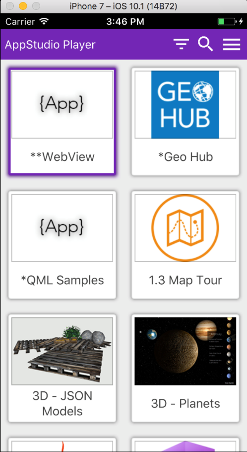

Getting started with iOS Simulators (Mac)
The iOS simulator is installed as a part of XCode. To start using the simulator device images you must first install XCode and command line tools 7.0+ from https://developer.apple.com/download/ (You don’t need an Apple Developer License to perform this action).

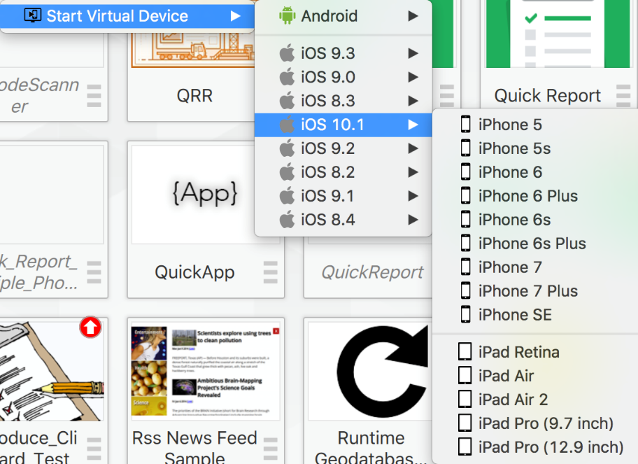

The simulator allows you to test apps with several SDK versions and operating systems. You can download additional simulator device images within XCode, open XCode and select Menu > XCode > Preferences > Select Components
After installing XCode, you can view a list of simulated devices when you click on the Virtual Device icon in AppStudio.

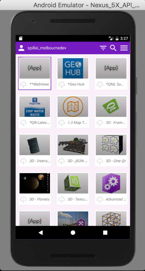

Getting started with Android Emulator (Windows, Linux & Mac)
To get started with the Android emulated environment, first you need to install Android Studio from https://developer.android.com/studio/index.html and create x86 device images from Android Virtual Device (AVD) https://developer.android.com/studio/run/managing-avds.html
Tip: For existing AppStudio customers you might have realized that now AppStudio supports Android x86 as a target platform. Though most of the physical Android devices out in the market are based on arm7, the emulator world is dominated by a much faster x86 version.
Points to remember while creating AVD images:
- Enable software rendering, otherwise AppStudio Player will not run. This slows the emulator down considerably, so setup the virtual device beforehand.
- Due to OpenGL limitations, set the minimum API support level to 23. Player will not run on any lower API level in emulation.

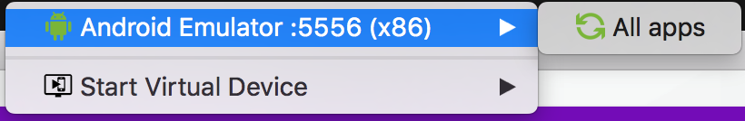

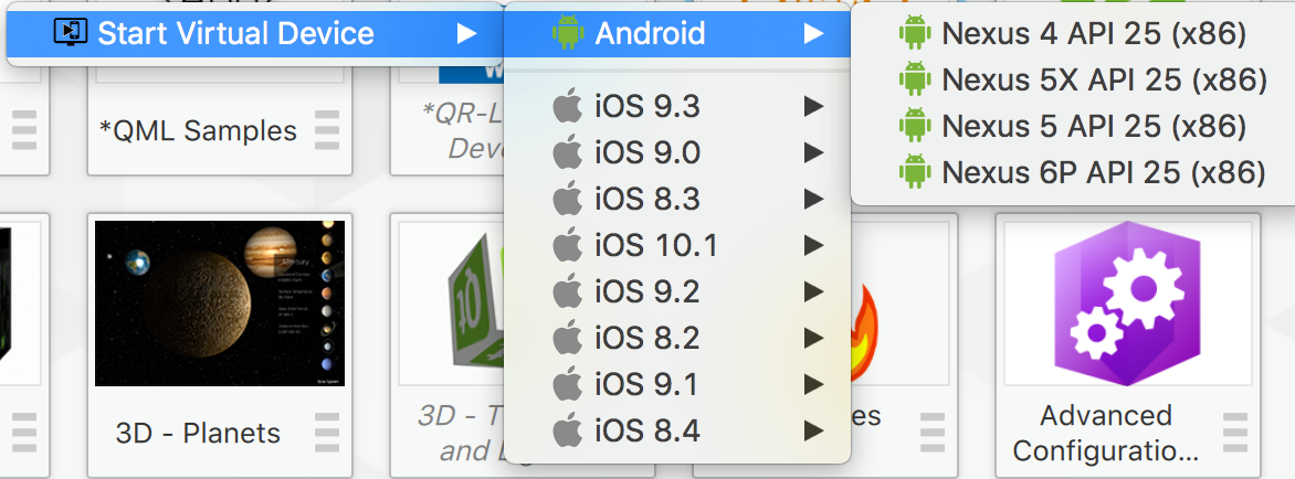

Click on the Virtual Device icon to see your Android emulator devices.
Select a device and whilst the emulator loads your device, apply sync, the AppStudio Player on an emulator doesn’t pick up the latest changes unless you have instructed it to do so.
