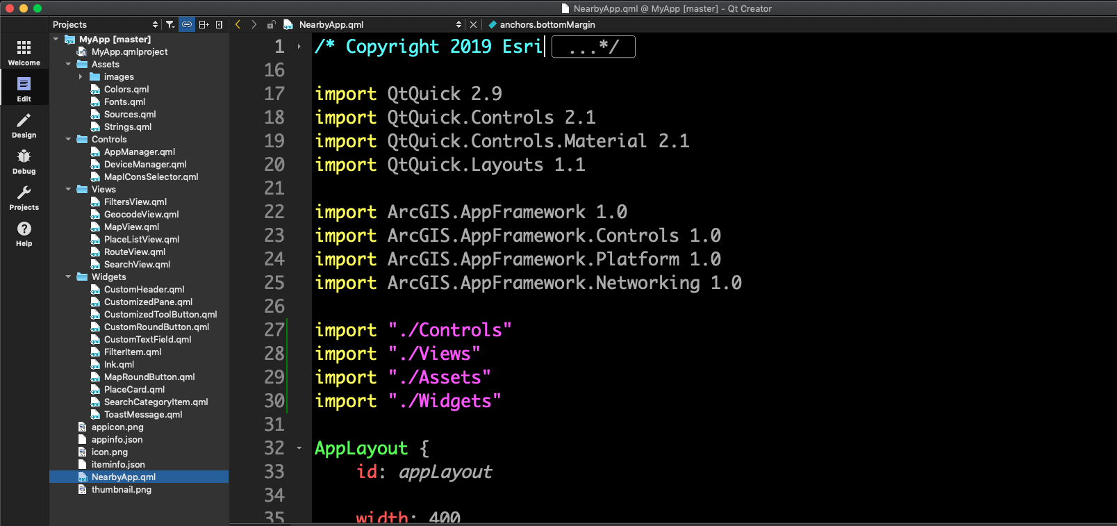

}Project Structure
When you open the sample files you will see that the project is divided into four folders as follows:
- Assets folder contains all localized assets such as images, text strings, and colors that are used in the app.
- Controls and Widgets contain components that are used to complete and manage the user interface.
- Views contain files that implement the main functionalities of the app.
- MapView.qml adds a map and provides all other functions for interacting with the map such as displaying graphics for found places and drawing routes.
- RouteView.qml implements routing functionalities.
- GeocodeView.qml, SearchView.qml, PlaceListView.qml and FiltersView.qml implement geocoding functionalities. We put these views in separated files in order to avoid having overly large code files.
