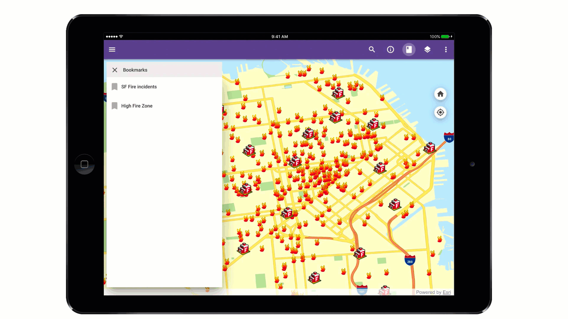

1. Adding Bookmarks – It’s always useful to add spatial bookmarks to provide shortcuts for future reference. When you are creating an MMPK, don’t forget to create bookmarks that can be used in your Map Viewer app. To do this:
Open ArcGIS Pro > Map > Bookmarks > New Bookmark > name the bookmark

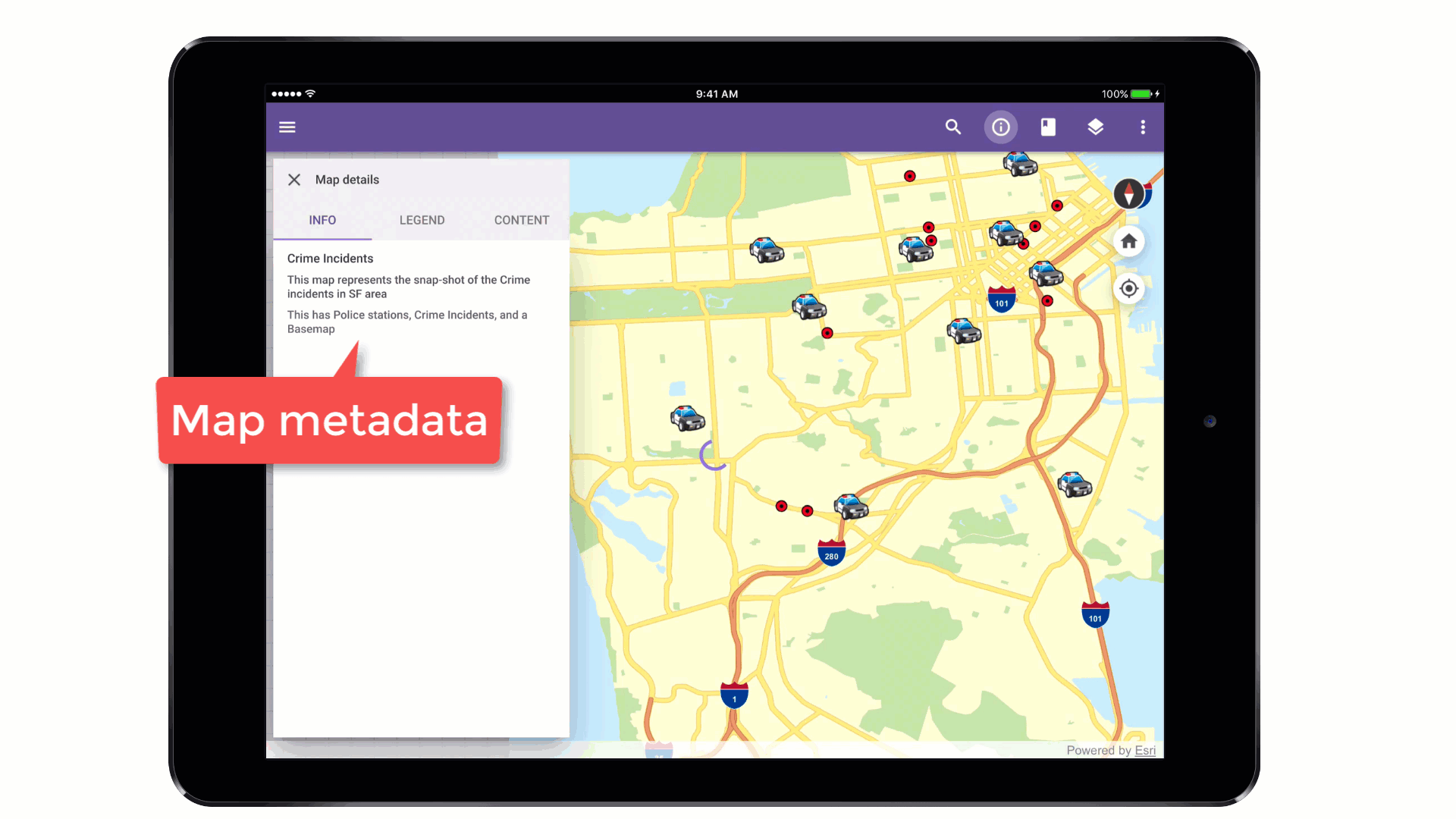

4. Changing map metadata
- Title – A map’s metadata title will be displayed at the top of the Map details Info panel. If you have multiple maps in the MMPK, the metadata title will also show on the Offline Maps Layer panel as the chosen options. By default, the metadata title is “Map”. You can always rename your map before uploading your MMPK.
- Summary and Description – A map’s metadata summary and description will also be displayed on the Map Viewer Info panel. You can provide additional information on the Map Viewer by adding metadata summary and description while creating an MMPK.
Note: One way to edit metadata information in ArcGIS Pro is to right-click on your map, then select Properties > Metadata.

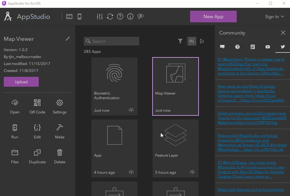

Step 1 Creating a Map Viewer template
Open AppStudio Desktop and sign in with a Standard license account. Click on the New App button > Templates > Map Viewer to created a new app based on the Map Viewer template.

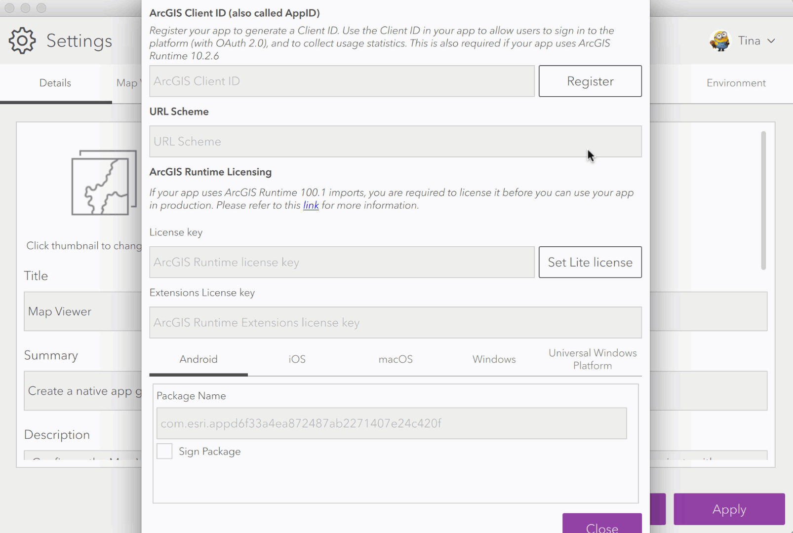

Step 2 Registering your app

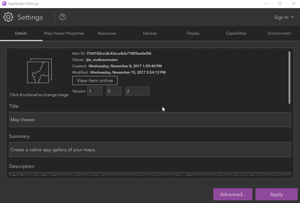

Sign-in is required to access and view MMPKs. This requires a Client ID, also known as an App ID to allow you to sign in. AppStudio Desktop 2.1 has provided a quick and easy way to generate a Client (App) ID to allow users to sign-in to your app, by navigating through AppStudio Settings > Advanced Settings, then clicking on the Register button.
Note: You can only register your app after uploading your app. So upload your app at least once before trying this step.

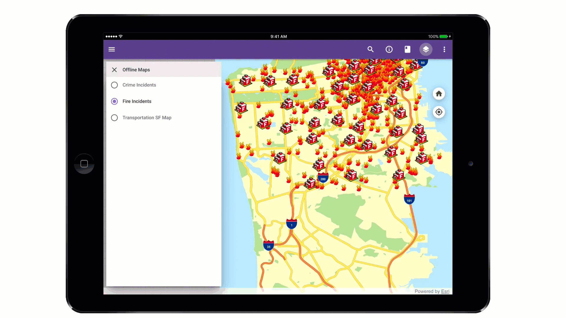

Just like when querying web maps, you can query MMPKs by item ID or tags. To display all of the MMPKs that have a specific tag in the Gallery page, you can simply enter the tag in the Settings > Gallery > Maps query. You can also enter an item ID in the Maps query field to search and display a specific MMPK in the Gallery. Note that if you want to specify more than one MMPK in the app, please use the following format:
(id: item A ID OR id: item B ID)
Step 5 Testing your App
Double click on the Map Viewer template app to run your app on Desktop with AppRun. Your offline maps (MMPKs) will appear in the "Offline Map" section of Gallery and you can download and view them from there. You can also quickly test your apps on a real device using AppStudio Player.
