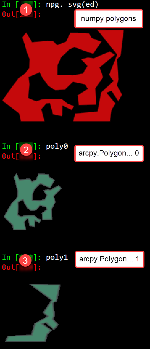

Some sample shapes appear to the right. Two polygons were created in ArcGIS Pro. The upper is their array representation as an svg graphic and the lower two are arcpy polygons similarly represented.
