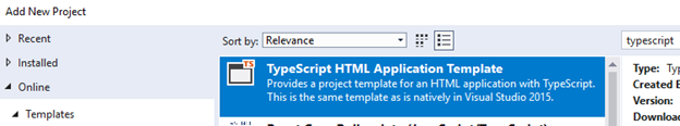

Being a user of Microsoft Visual Studio since version 6.0, I prefer it as a one-stop shop for as many kinds of development as possible, including C++, VB, C#, Python, and HTML5/TypeScript projects. One feature of VS that I really like is the ability to create project templates. VS2015 included a project template for TypeScript, but it was ugly as sin. VS2017 dropped it, but failed to provide a viable alternative; being lazy, I continued to use the same version available online:
This must stop! Sometimes, you just have to get your hands dirty, so I decided to create my own project template from scratch. Fortunately, the TypeScript documentation has sections on Integrating with Build Tools, and Compiler Options in MSBuild, which provided valuable assistance. Also, see the MSBuild documentation and How to: Create project templates for more information.

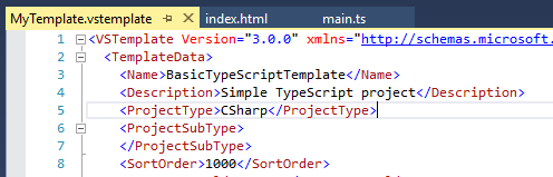

At this point, if you export the project to a template, you have a generic TypeScript project template. However, it will be displayed under the “Visual C#” category. If you want it to appear under the “TypeScript” category, there are additional steps to take. First, unzip the template to a new folder and edit “MyTemplate.vstemplate:”
Change the “ProjectType” value from “CSharp” to “TypeScript”. Zip the contents of the folder to a new zip file, and the template is ready to use.

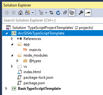

Back in Solution Explorer, select the project and click the “Show All Files” button. Select the “node_modules” folder, “package.json,” and “package-lock.json,” right-click, and select “Include In Project.” Finally, replace the contents of “main.ts” and “index.html” with the text given at the JSAPI TypeScript walk-through. Your project should now look like this:
You may notice that the “import” statements in “main.ts” are marked as errors, even though the esModuleInterop flag is set in the project:
This appears to be a defect in the Visual Studio extension. The project will build without errors, and the resulting page will load correctly. If it annoys you, you can always revert to the older AMD style statements:
