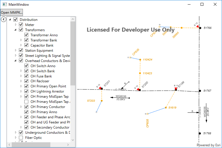

I've attached an example Visual Studio project which retrieves the .info and .mmap files to extract the operational layer definitions:

Then it opens the map and restructures it to insert group layers in the appropriate places.

As a bonus, the example code also builds an interactive TOC.
