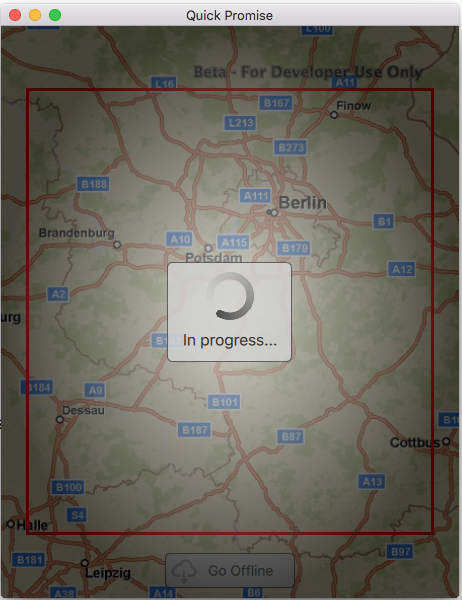

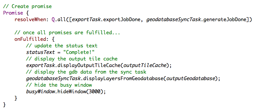

- Finally, I imported the QuickPromise plugin in my QML file, and I created a Promise. I set the Promise's resolveWhen property to list a list of signals (each signal emits when one of the offline tasks completes). Finally, I created a signal handler for the fulfilled signal- this signal will emit once all of the promises are resolved. In this case, I want to update the download screen once all of the promises are resolved, and I also want to switch out my online layers to my offline layers.
This worked wonderfully, and was very simple to setup and use. I found that this particular usage of QuickPromise worked wonderfully for the declarative type QML workflow. Beyond this, there are several other ways you can use QuickPromise, both declaratively, and in imperative JavaScript code. Many of the alternative functions fit more into the traditional pattern of how a JavaScript Promise is used in a web application (e.g. a then() function). The alternative methods of creating a promise in QML are documented here.
