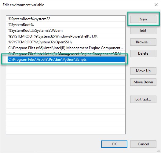

2. Add the ArcGIS Pro helper scripts that come with Pro to your system path environment variables. This will allow you to run conda in the command prompt.

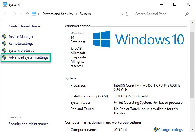

On your Windows device, search for and open System (control panel)
In the System window, click Advanced system settings.

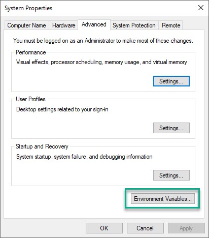

In the System Properties window, click Environment Variables.

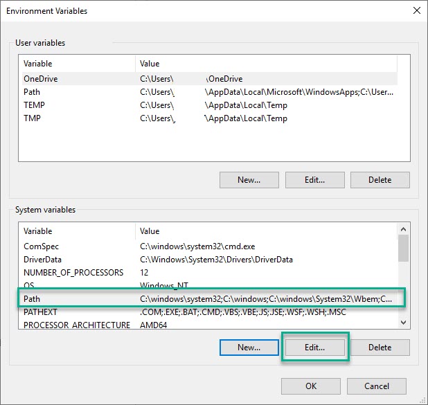

In the Environment Variables window, under System variables, select Path. Then, click Edit.
In the Edit environment variable window, click New, and add the file path to the ArcGIS Pro Python scripts.
Here is the default file path: C:\Program Files\ArcGIS\Pro\bin\Python\Scripts
Click OK.

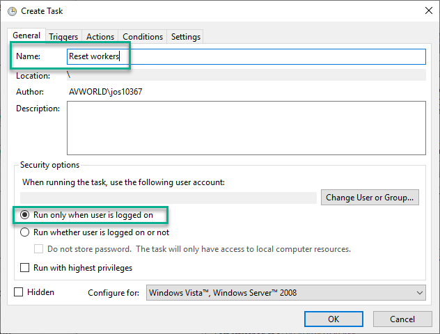

1. In the Windows Start menu, search for "Task Scheduler" and open the program. Click Actions > Create task. In the Create Task dialog box, name the task “Reset Workers” and select the Run whether user is logged on or not security option.

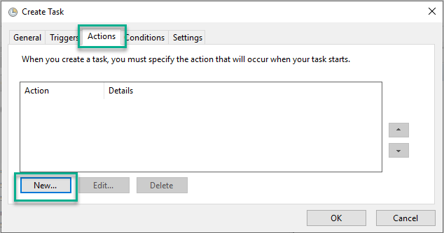

2. In the Create Task dialog box, click Actions > New.
The New Action window appears.

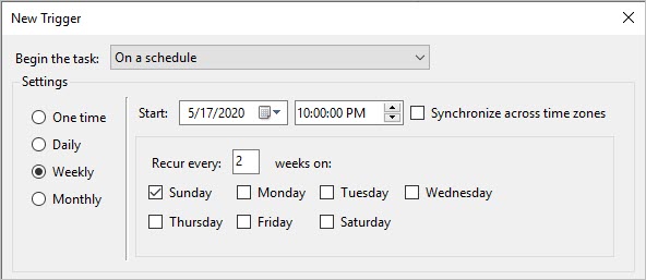

3. Create a new trigger

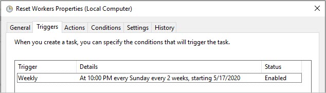

In the Create Task dialog box, on the Triggers tab, click New to open the New Trigger window. This is where you set how often you want your script to run. For this exercise, the script is set to run every two weeks on Sunday at 10:00PM.
Click OK to close the New Trigger window. The trigger you just created is now listed in the Triggers tab.
You can set multiple triggers for your script, depending on the needs of your Workforce project. Click OK to close the Reset Workers Properties window.

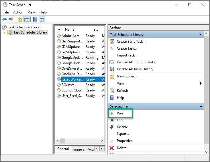

The reset_stale_workers script is now set to run every other Sunday. If you want to test that this script will work, you can run it manually at any time. Select the script in the Task Scheduler Library and click Run.
After running the script, you can view the log file to confirm that it worked.
