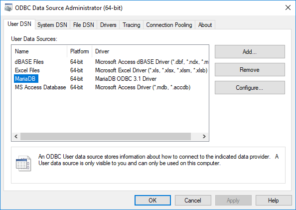

For my example source I chose MariaDB, a binary equivalent to MySQL. After installing MariaDB and the appropriate 64bit ODBC driver I imported some CSV data and created a user-level ODBC data source in Windows. Here is how the admin tool looks (click on images to enlarge them):

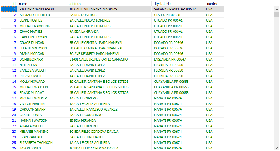

MariaDB ships with a handy administration utility - HeidiSQL - here is how the Data view of my target data looks in HeidiSQL (the names and addresses are made up):

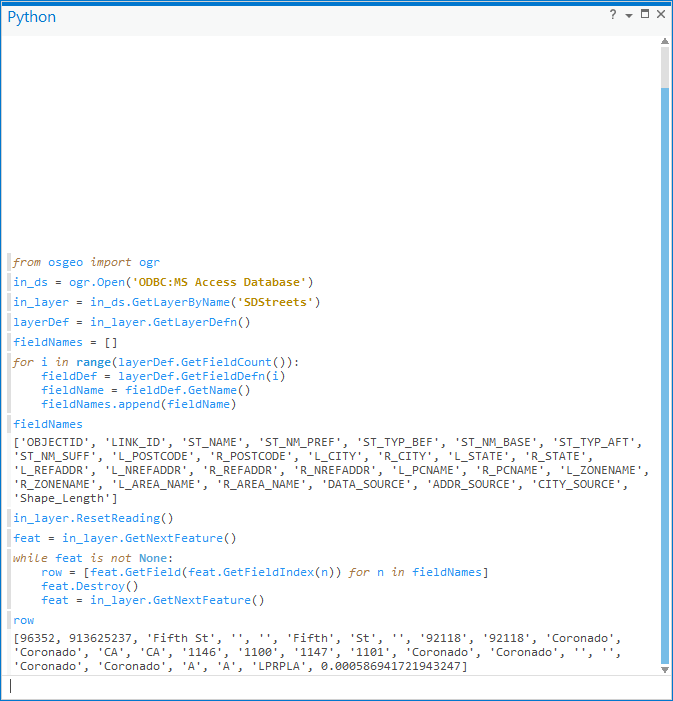

So that's my target data, now how to get at it? To understand what the osgeo module needs to connect to my ODBC source I researched the relevant vector driver. So far so good. With a little more surfing some examples and the submodule osgeo.ogr API the parts were apparent. Next step - code it! Here is the result in my project:

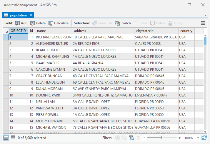

...and the output table is created in my project home geodatabase.
Success! I imported 6000 rows in about 8 seconds. So that is the pattern I wanted to show. The approach will handle more data types than just the string and integer values I used, and it is quite likely the part of my code where I map OGR field types to ArcGIS field types has issues. Please do comment in this blog space on your challenges and successes.

I have 64bit Office on my machine, I also have Microsoft Access Runtime 2013 installed, I'm not entirely sure if both are needed or just one but my ODBC datasource options include .mdb and .accdb. Otherwise the pattern to reading Access databases is the same as the above. I configured an ODBC MS Access Database connection in the 64bit ODBC administrator to connect to an .accdb database on disk. I possibly should have added a new one and given it a descriptive name but you get the idea. From there it is just like any other ODBC source, except it does have a dependency on 64bit Office and/or the runtime driver.
