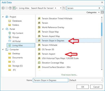

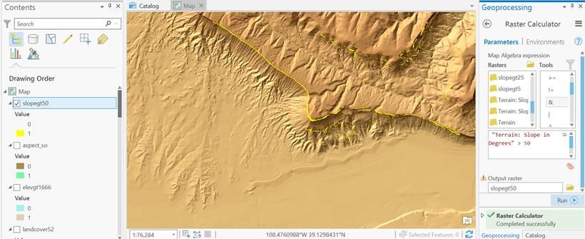

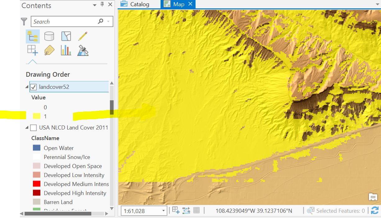

If you want to simply visualize elevation, slope, aspect, and land cover, for example, use Add Data > Portal > Living Atlas > search for these layers and add them to your map view in ArcGIS Pro. To do analysis on land cover, elevation, slope, or aspect, you need to select such items as “terrain: slope in degrees” – and “aspect” – not the map, but the service. Also important is to use Environments in the raster calculator (or any other geoprocessing tool that you are using) to set the analysis extent to your display, a watershed, or some other specific area so you’re not analyzing the whole country or the whole world!. See screens below (my study area is the wonderful terrain in western Colorado).
The results of my raster calculator on streaming terrain--the thin yellow areas are where the slopes are greater than 50 degrees.
Results after Raster Calculator analysis was applied to the streaming NLCD Land Cover data, with shrub/scrub land cover shown in yellow.
Searching for Terrain Slope in Degrees and Terrain Aspect (direction of slope) from the Living Atlas, using the Add Data tool in ArcGIS Pro.
