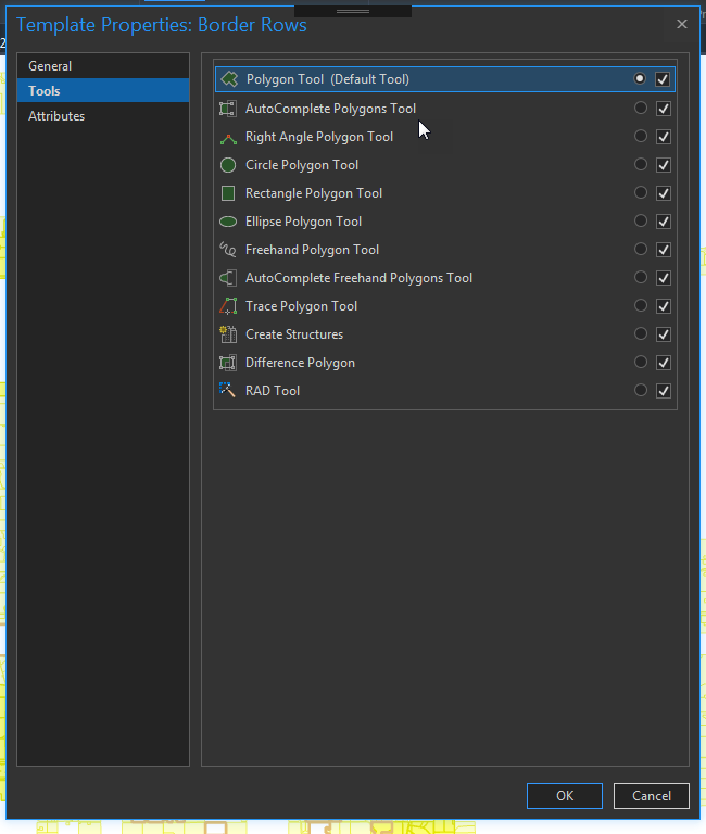

I want to programatically remove some tools from my configuration that I don't want a user to be able to use and also to set a default tool other than polygon. So below for my Active template, I ant to remove all tools but polygon and RAD Tool, then make the RAD Tool the default. I feel like I need to update the ToolOptions of the CIMEditingTemplate, but it is always null? Am I even on the correct place to accomplish this?
