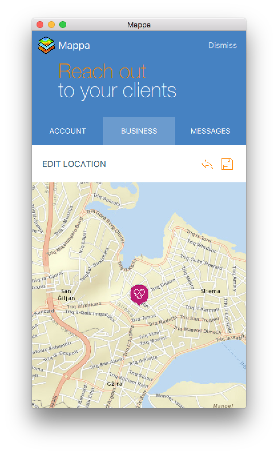

So in the mobile app I’m working on we want to give the user the possibility to reposition his business’ location on the map. The way we want this to work, visually, is present the user with a map he can drag to set the wanted location in the center of the map view. There’s an image on top of the map to indicate its center. This is what the UI looks like:
When the view to edit the location (the image above) is loaded, I want the map to pan and zoom to the current location. However, I cannot get this to work – the map always seems to zoom to the 0,0 coordinates. This is how I’m trying to achieve this:
