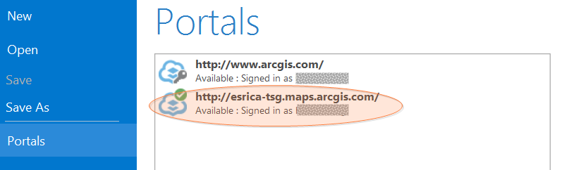

I set up the portal in Project/Portals:
And I want to use that setting.
