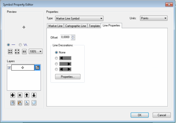

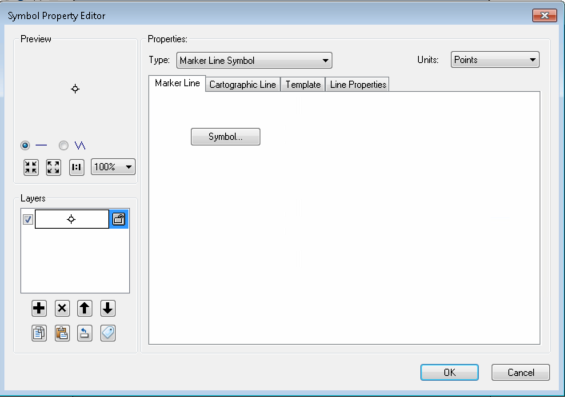

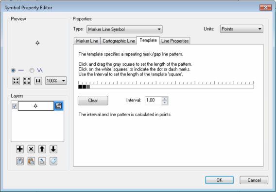

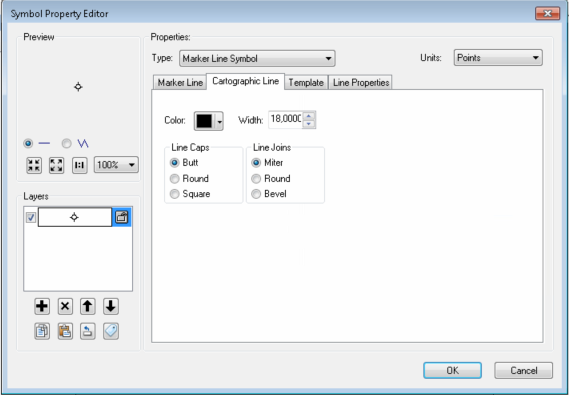

Here is how I defined the symbology (e.g. for values Dry, VERTICAL):
In ArcMap I zoom in to a "Dry, VERTICAL" feature and I see it correctly.

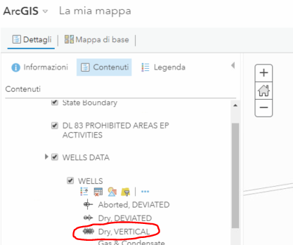

From ArcGIS Online I visualize my Map Service and zoom in the same zone but I can't see the feature (only a label is displayed but this stays in another layer):
Also, look at the difference in the legend from AGOL:
