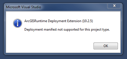

Using the Class Library project type in VS 2013, I've created a WPF user control that is to be consumed by several host applications. When I right click on the project in my solution and choose 'Add ArcGIS Runtime .NET Deployment Manifest' I receive a message stating that the 'Deployment manifest not supported for this project type.'
It works with a WPF Application project type, just not a Class Library. Is there a work around or hack that will allow the deployment manifest to work in a Class Library project? Or is there another way to ensure that only the necessary portions of the runtime are deployed with my assembly?
