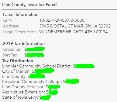

I have a service that has a polygon feature class representing parcels, and a related table populated with tax history data. Using Arcade, I'm able to build a pop-up in a web map that displays the tax information for each tax authority.
However, this only seems to work in ArcGIS Online (AGO). If I use the same service, and the same Arcade expressions within Portal (10.7.1), the pop-up does not display, or seem to retrieve any of the related table information, specifically when calling an iterator to get the individual rows within the related table feature set.
If I use the Console function to test if the FeatureSet is returning/finding anything, it seems to indicate that the related records are being found in Portal, as the number of related tax records found is correct...but none of the individual rows within the related table feature set are being returned.
Is this a known issue/bug in Portal...?...is there some sort of performance issue in Portal when it comes to retrieving the data?
Any ideas...?
Below is the Arcade expression being used, and console returns between both AGO and Portal. AGO returns what I want, Portal does not ... like I said, seems to be specific to the iterator.

<SPAN class="keyword token">return</SPAN> p<SPAN class="line-numbers-rows"><SPAN></SPAN><SPAN></SPAN><SPAN></SPAN><SPAN></SPAN><SPAN></SPAN><SPAN></SPAN><SPAN></SPAN><SPAN></SPAN><SPAN></SPAN><SPAN></SPAN><SPAN></SPAN><SPAN></SPAN><SPAN></SPAN><SPAN></SPAN><SPAN></SPAN><SPAN></SPAN><SPAN></SPAN><SPAN></SPAN><SPAN></SPAN><SPAN></SPAN><SPAN></SPAN><SPAN></SPAN><SPAN></SPAN><SPAN></SPAN><SPAN></SPAN><SPAN></SPAN><SPAN></SPAN><SPAN></SPAN><SPAN></SPAN><SPAN></SPAN><SPAN></SPAN><SPAN></SPAN><SPAN></SPAN><SPAN></SPAN><SPAN></SPAN><SPAN></SPAN><SPAN></SPAN><SPAN></SPAN><SPAN></SPAN><SPAN></SPAN><SPAN></SPAN></SPAN>Related table pop-up working in ArcGIS Online
AGO console test --- iterator working
