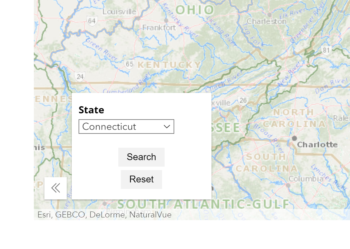

This could potentially also go into the storymap community. I used the ArcGIS API for JavaScript to build an application (with the periodic help of the great folks here). I'm embedding it into a storymap (using the new builder). My application has a drop down menu element that allows users to select values used in a queryTask:

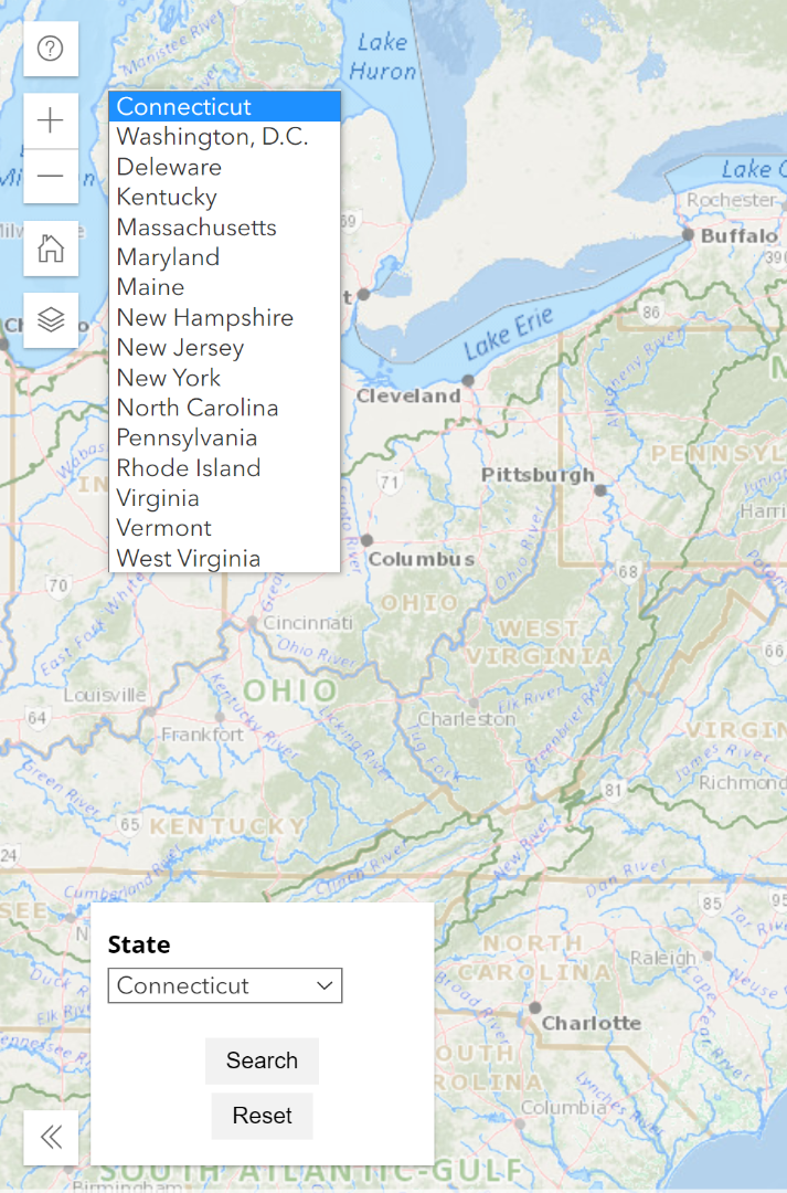

When the application is placed in the main stage of the sidecar or embedded at small or medium size on the page, the drop down menu does not remain in the correct position. It moves with the page if you open it and scroll:
Is this something I can fix by adjusting my application code? In this example application, the select menu remains in position/closes when the user scrolls down the page: QueryTask | ArcGIS API for JavaScript 4.17
The following are parts of the script that correspond to the select menu (I've tried toggling the relative/absolute settings for several of the elements without success):
