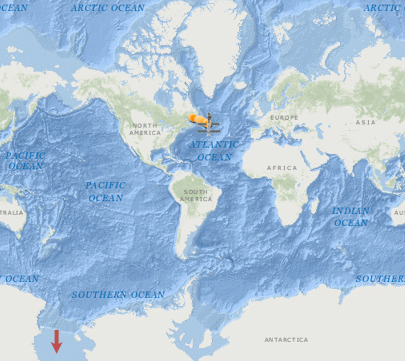

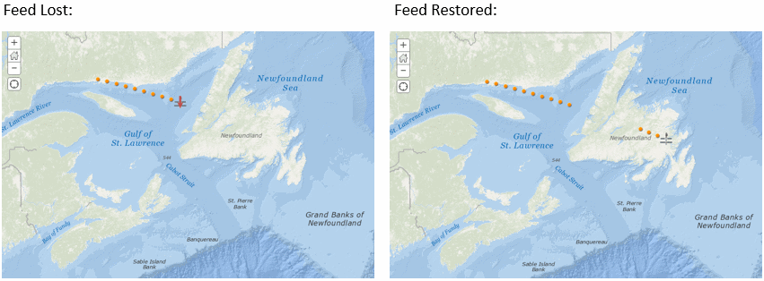

Then when looking at your map you'd see something like:
A true/complete view of the web map is really more like the illustration below.
(The lost signal icon has just been moved to a location you're not likely to encounter it)
