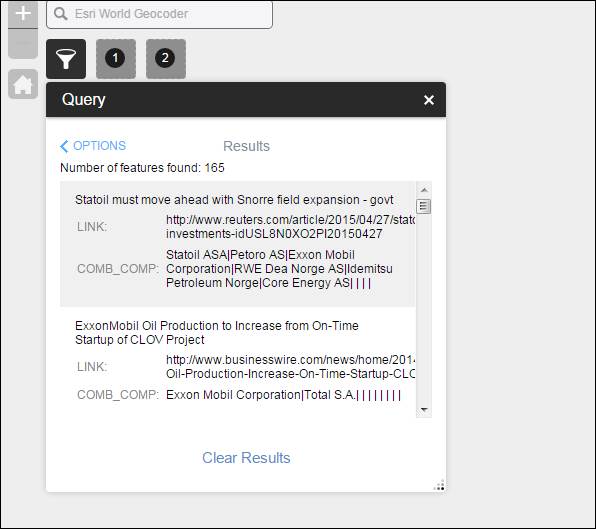

Below is a Filter Definition for a query. It is set up so the user enters a string and the query checks if the string is contained within the field.
The problem occurs after the query is run. The results window displays properly, but the map does not display (just a gray screen, as shown below behind the results window). Also, the scale bar shows “NaNmi” instead of the normal scale bar notation. I cannot zoom in or out.
The only way to get the map visible again is to hit the “Home” button. Now back on the original extent, the map displays properly with the query results symbolized.
