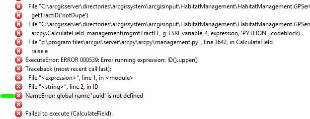

I have a service that chooses whether to give a field one value or another depending on what's present in the data already. When I run the python script outside of the server, it runs fine. When I run it on the server, it fails because it doesn't recognize the uuid module in the code block. I think it's treating uuid as a string, but to use code blocks you pass in the whole code block as a string. Has anybody successfully used code blocks in their GP services?

On my server it converts 'ID().upper()' into a g_ESRI_variable. I still don't get why it would affect it's efficacy though. The 'expression' variable would still be a string.
g_ESRI_variable_3 <SPAN class="operator token">=</SPAN> u<SPAN class="string token">'ID().upper()'</SPAN>

codeblock <SPAN class="operator token">=</SPAN> <SPAN class="string token">"""def ID():
return '{' + str(uuid.uuid4()) + '}'"""</SPAN>
expression <SPAN class="operator token">=</SPAN> g_ESRI_variable_3
arcpy<SPAN class="punctuation token">.</SPAN>CalculateField_management<SPAN class="punctuation token">(</SPAN>mgmtTractFL<SPAN class="punctuation token">,</SPAN> g_ESRI_variable_4<SPAN class="punctuation token">,</SPAN> expression<SPAN class="punctuation token">,</SPAN> <SPAN class="string token">'PYTHON'</SPAN><SPAN class="punctuation token">,</SPAN> codeblock<SPAN class="punctuation token">)</SPAN><SPAN class="line-numbers-rows"><SPAN></SPAN><SPAN></SPAN><SPAN></SPAN><SPAN></SPAN><SPAN></SPAN><SPAN></SPAN><SPAN></SPAN><SPAN></SPAN><SPAN></SPAN><SPAN></SPAN><SPAN></SPAN><SPAN></SPAN></SPAN>If this can't be figured out, I can always use a cursor but I figure CalculateField would be faster when there's 1000+ records.
