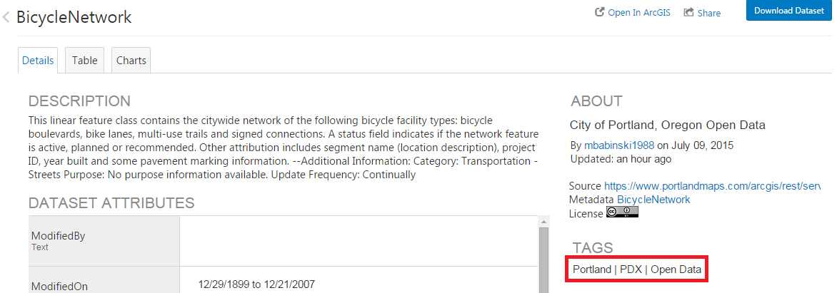

1. Now the datasets are showing up on the Open Data site (still Private while in development), but since the AGOL item is a "map image layer," each layer has the same tags - the ones provided for the service:
As you can see the feature layer description came through but the tags are service-level tags. I'd like to give each layer tags specific to that layer (we maintain these in a SQL Server database). I've experimented with registering individual feature layers from the open data service in AGOL but I'm worried that if the index of the layer changes when I republish the service that the connection may break, and then with 75+ layers to add this will be very time consuming. So, is there a way to register a service with AGOL in a way that each feature layer is individually added, so that they may be given individual tags?

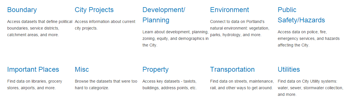

2. I've created ten text widgets in the Open Data site, each with a link leading to a formatted url that queries the category name:
(Boundary is http://data.pdx.opendata.arcgis.com/datasets?q=boundary&sort_by=relevance)
So, how do I structure the tags, metadata, etc for the particular layers so that only the desired layers show up under a search of "boundary?"
