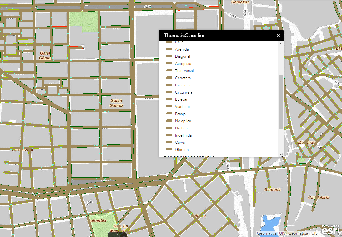

Hi,
I have a problem with this render.
I'm trying to diferenciate the posible values from a domain field (with respective coded values). The render receive a symbol and the field. And then I'm going code value by code value (into foreach) assigning diferents color and label.
But the result is that the render is drawing all codedvalues with the last color assigned.
