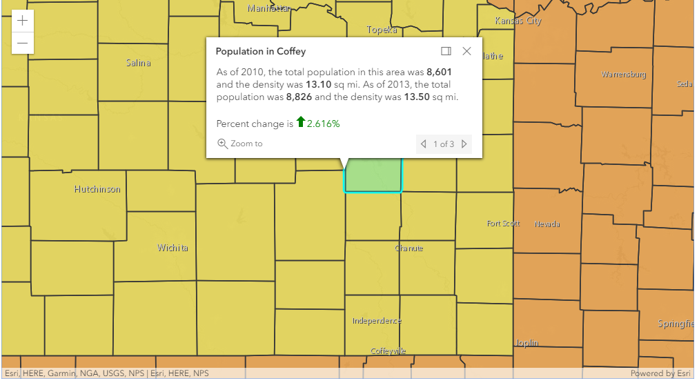

ArcGIS Javascript 4.12 removed the support of the custom function for each field. Previously I was able to update the set something like below to update the format of POP2013.
<SPAN class="keyword token">var</SPAN> popupTemplate <SPAN class="operator token">=</SPAN> <SPAN class="keyword token">new</SPAN> <SPAN class="token class-name">PopupTemplate</SPAN><SPAN class="punctuation token">(</SPAN><SPAN class="punctuation token">{</SPAN>
title<SPAN class="punctuation token">:</SPAN> <SPAN class="string token">"Population in {NAME}"</SPAN><SPAN class="punctuation token">,</SPAN>
content<SPAN class="punctuation token">:</SPAN> <SPAN class="string token">"As of 2010, the population in this area was <b>{POP2010:NumberFormat}</b>."</SPAN> <SPAN class="operator token">+</SPAN>
<SPAN class="string token">"As of 2013, the population here was <b>{POP2013:NumberFormat}</b>."</SPAN> <SPAN class="operator token">+</SPAN>
<SPAN class="string token">"Percent change is {POP2013:populationChange}"</SPAN>
<SPAN class="punctuation token">}</SPAN><SPAN class="punctuation token">)</SPAN><SPAN class="punctuation token">;</SPAN>
populationChange <SPAN class="operator token">=</SPAN> <SPAN class="keyword token">function</SPAN> <SPAN class="punctuation token">(</SPAN>value<SPAN class="punctuation token">,</SPAN> key<SPAN class="punctuation token">,</SPAN> data<SPAN class="punctuation token">)</SPAN> <SPAN class="punctuation token">{</SPAN>
<SPAN class="comment token">// calculate the population percent change from 2010 to 2013.</SPAN>
<SPAN class="punctuation token">}</SPAN><SPAN class="line-numbers-rows"><SPAN></SPAN><SPAN></SPAN><SPAN></SPAN><SPAN></SPAN><SPAN></SPAN><SPAN></SPAN><SPAN></SPAN><SPAN></SPAN><SPAN></SPAN><SPAN></SPAN></SPAN>In the new version, however, the code need to be updated to:
<SPAN class="keyword token">let</SPAN> popupTemplate <SPAN class="operator token">=</SPAN> <SPAN class="punctuation token">{</SPAN>
<SPAN class="comment token">// autocasts as new PopupTemplate()</SPAN>
content<SPAN class="punctuation token">:</SPAN> populationChange<SPAN class="punctuation token">,</SPAN>
fieldInfos<SPAN class="punctuation token">:</SPAN> <SPAN class="punctuation token">[</SPAN><SPAN class="punctuation token">{</SPAN>
fieldName<SPAN class="punctuation token">:</SPAN> <SPAN class="string token">"POP2010"</SPAN><SPAN class="punctuation token">,</SPAN>
format<SPAN class="punctuation token">:</SPAN> <SPAN class="punctuation token">{</SPAN>
digitSeparator<SPAN class="punctuation token">:</SPAN> <SPAN class="keyword token">true</SPAN><SPAN class="punctuation token">,</SPAN>
places<SPAN class="punctuation token">:</SPAN> <SPAN class="number token">0</SPAN>
<SPAN class="punctuation token">}</SPAN><SPAN class="punctuation token">,</SPAN><SPAN class="punctuation token">{</SPAN>
fieldName<SPAN class="punctuation token">:</SPAN> <SPAN class="string token">"POP10_SQMI"</SPAN><SPAN class="punctuation token">,</SPAN>
places<SPAN class="punctuation token">:</SPAN> <SPAN class="number token">2</SPAN>
fieldName<SPAN class="punctuation token">:</SPAN> <SPAN class="string token">"POP2013"</SPAN><SPAN class="punctuation token">,</SPAN>
fieldName<SPAN class="punctuation token">:</SPAN> <SPAN class="string token">"POP13_SQMI"</SPAN><SPAN class="punctuation token">,</SPAN>
<SPAN class="punctuation token">}</SPAN><SPAN class="punctuation token">]</SPAN>
<SPAN class="punctuation token">}</SPAN><SPAN class="punctuation token">;</SPAN>
<SPAN class="keyword token">function</SPAN> populationChange <SPAN class="punctuation token">(</SPAN>feature<SPAN class="punctuation token">)</SPAN> <SPAN class="punctuation token">{</SPAN>
<SPAN class="keyword token">let</SPAN> diff <SPAN class="operator token">=</SPAN> feature<SPAN class="punctuation token">.</SPAN>graphic<SPAN class="punctuation token">.</SPAN>attributes<SPAN class="punctuation token">.</SPAN>POP2013 <SPAN class="operator token">-</SPAN> feature<SPAN class="punctuation token">.</SPAN>graphic<SPAN class="punctuation token">.</SPAN>attributes<SPAN class="punctuation token">.</SPAN>POP2010<SPAN class="punctuation token">;</SPAN>
<SPAN class="keyword token">let</SPAN> pctChange <SPAN class="operator token">=</SPAN> <SPAN class="punctuation token">(</SPAN>diff <SPAN class="operator token">*</SPAN> <SPAN class="number token">100</SPAN><SPAN class="punctuation token">)</SPAN> <SPAN class="operator token">/</SPAN> feature<SPAN class="punctuation token">.</SPAN>graphic<SPAN class="punctuation token">.</SPAN>attributes<SPAN class="punctuation token">.</SPAN>POP2010<SPAN class="punctuation token">;</SPAN>
<SPAN class="keyword token">let</SPAN> arrow <SPAN class="operator token">=</SPAN> diff <SPAN class="operator token">></SPAN> <SPAN class="number token">0</SPAN> <SPAN class="operator token">?</SPAN> upArrow <SPAN class="punctuation token">:</SPAN> downArrow<SPAN class="punctuation token">;</SPAN>
<SPAN class="comment token">// add green arrow if the percent change is positive.</SPAN>
<SPAN class="comment token">// red arrow for negative percent change.</SPAN>
<SPAN class="keyword token">return</SPAN> <SPAN class="punctuation token">(</SPAN>
"As <SPAN class="keyword token">of</SPAN> <SPAN class="number token">2010</SPAN><SPAN class="punctuation token">,</SPAN> the total population <SPAN class="keyword token">in</SPAN> <SPAN class="keyword token">this</SPAN> area was <SPAN class="punctuation token">{</SPAN>POP2010<SPAN class="punctuation token">}</SPAN> and the density was <SPAN class="punctuation token">{</SPAN>POP10_SQMI<SPAN class="punctuation token">}</SPAN> sq mi<SPAN class="punctuation token">.</SPAN>
As <SPAN class="keyword token">of</SPAN> <SPAN class="number token">2013</SPAN><SPAN class="punctuation token">,</SPAN> the total population was <SPAN class="punctuation token">{</SPAN>POP2013<SPAN class="punctuation token">}</SPAN> and the density was <SPAN class="punctuation token">{</SPAN>POP13_SQMI<SPAN class="punctuation token">}</SPAN> sq mi<SPAN class="punctuation token">.</SPAN>
<SPAN class="operator token"><</SPAN>br <SPAN class="operator token">/</SPAN><SPAN class="operator token">></SPAN> <SPAN class="operator token"><</SPAN>br <SPAN class="operator token">/</SPAN><SPAN class="operator token">></SPAN><SPAN class="string token">" + "</SPAN>Percent change is <SPAN class="string token">" + arrow + "</SPAN><SPAN class="operator token"><</SPAN>span style<SPAN class="operator token">=</SPAN>'color<SPAN class="punctuation token">:</SPAN> <SPAN class="string token">" + (pctChange < 0 ? "</SPAN>red<SPAN class="string token">" : "</SPAN>green"<SPAN class="punctuation token">)</SPAN> <SPAN class="operator token">+</SPAN>
<SPAN class="string token">";'>"</SPAN> <SPAN class="operator token">+</SPAN> pctChange<SPAN class="punctuation token">.</SPAN><SPAN class="token function">toFixed</SPAN><SPAN class="punctuation token">(</SPAN><SPAN class="number token">3</SPAN><SPAN class="punctuation token">)</SPAN> <SPAN class="operator token">+</SPAN> <SPAN class="string token">"%</span>"</SPAN>

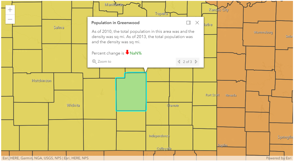

<SPAN class="punctuation token">}</SPAN><SPAN class="punctuation token">;</SPAN><SPAN class="line-numbers-rows"><SPAN></SPAN><SPAN></SPAN><SPAN></SPAN><SPAN></SPAN><SPAN></SPAN><SPAN></SPAN><SPAN></SPAN><SPAN></SPAN><SPAN></SPAN><SPAN></SPAN><SPAN></SPAN><SPAN></SPAN><SPAN></SPAN><SPAN></SPAN><SPAN></SPAN><SPAN></SPAN><SPAN></SPAN><SPAN></SPAN><SPAN></SPAN><SPAN></SPAN><SPAN></SPAN><SPAN></SPAN><SPAN></SPAN><SPAN></SPAN><SPAN></SPAN><SPAN></SPAN><SPAN></SPAN><SPAN></SPAN><SPAN></SPAN><SPAN></SPAN><SPAN></SPAN><SPAN></SPAN><SPAN></SPAN><SPAN></SPAN><SPAN></SPAN><SPAN></SPAN><SPAN></SPAN><SPAN></SPAN><SPAN></SPAN><SPAN></SPAN><SPAN></SPAN><SPAN></SPAN><SPAN></SPAN><SPAN></SPAN><SPAN></SPAN></SPAN>But if there are two of more features selected, feature attributes except the first feature became "Undefined". You can see no values and NaN error when you go to the next feature from popup. Please see the below screenshots.
a) first feature
b) second feature
All codes and screenshots are from: https://developers.arcgis.com/javascript/latest/sample-code/popuptemplate-function/index.html
Please fix this and also let me know if there is any work-around.
