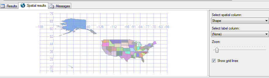

- In SSMS, query the table and select "Spatial Results". Note how SSMS shows the US States;
- If there was invalid geography, SSMS WOULD NOT show the states!
