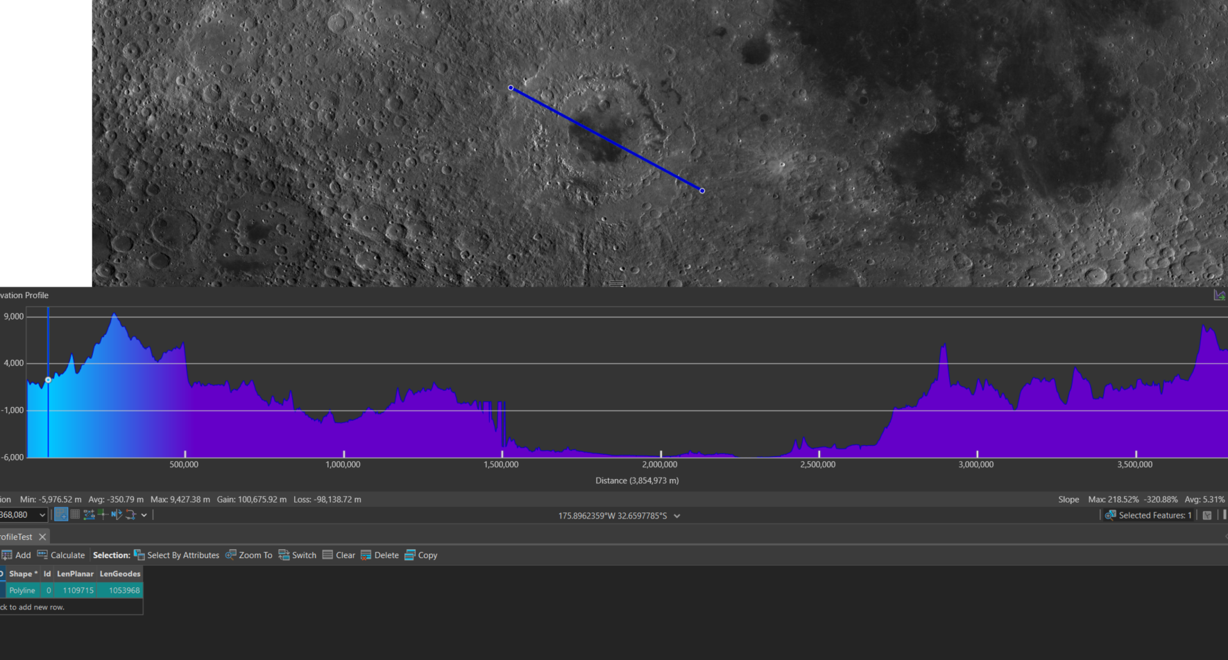

This screenshot illustrates the error; the actual planar and geodesic measurements are in the attribute table.
