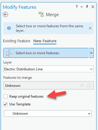

The challenge with the default option in the merge tool is that it deletes the original features being merged. This prevents attribute rule from easily querying the original features and perform custom logic. To allow for more a flexible behavior, we will need to modify some options.
To achieve more control, we will be using the option to keep the original features in the merge tool, and let the attribute rules do the delete instead. This gives us more control as it turns the operation from a delete, update (delete the original feature, and update the geometry of the merged feature), to an update only. We will write the rule to trigger on update on geometry using the new triggering fields to set the rule to only trigger on shape change.
