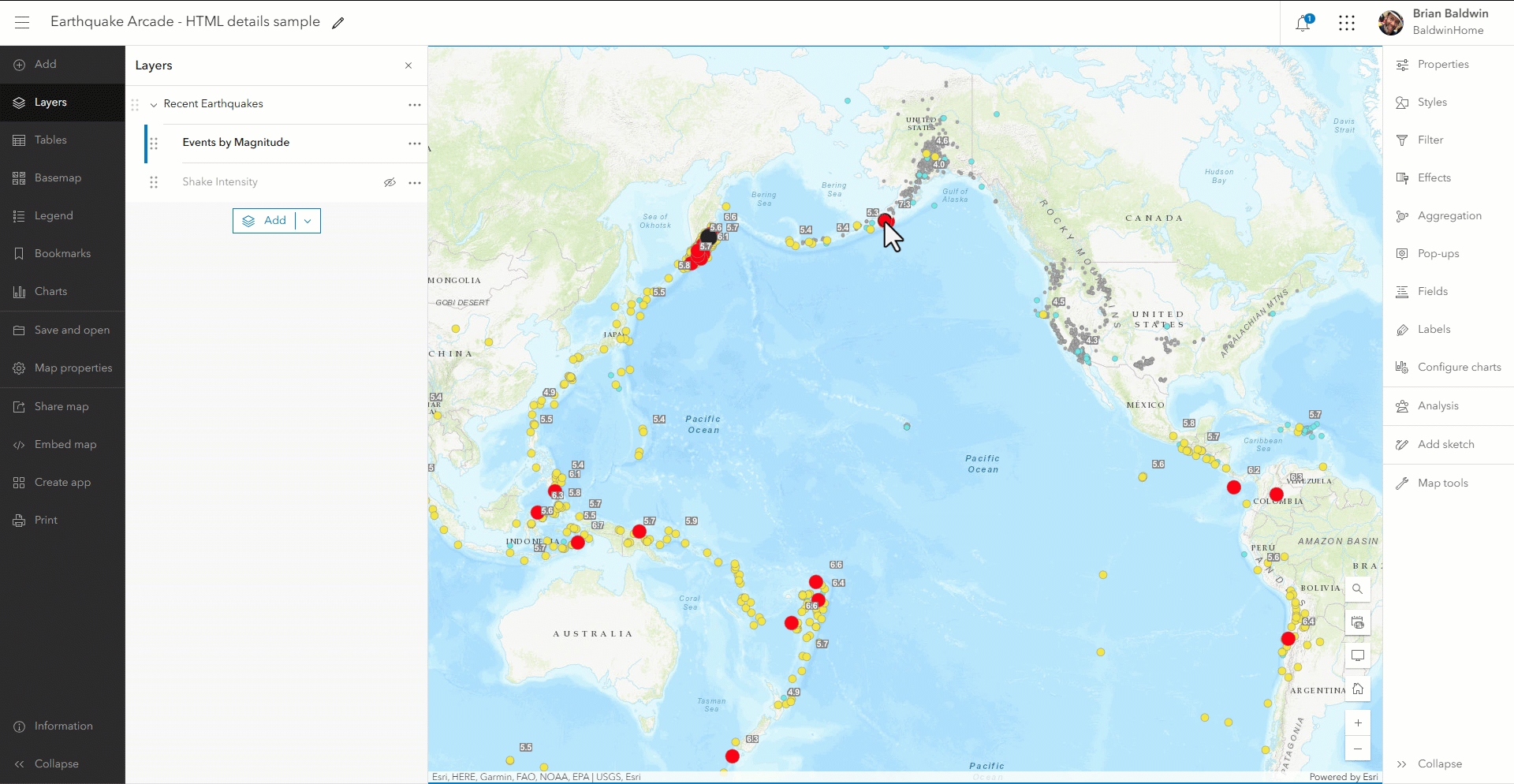

If you want to explore my map on your own, please open the map here: https://arcg.is/5XjT8
(You can then click on Layers, Events by Magnitude, and then look at the HTML in the pop-up and the Arcade expressions to get the 'colors)

Toss that <dl> into the <details>
In the example, I put a 2nd <dl> into a <detail> - so that we could make a hidden table of information. This is a great way to include a lot of information, but let users choose whether or not they want to see/engage with it.
So, please go explore the <details> element, it’s a clean and easy way to build some nice collapsible content structures for your pop-up!
