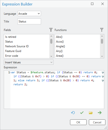

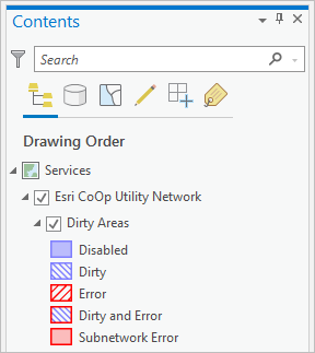

If you've looked at the dirty area before you have seen it has many different status values:
If you've look at how these values are defined for the layer, you will see that they are calculated using an Arcade Expression.
So how do you use that expression in something like Select By Attributes or a Definition query?
The secret to filtering out edits is to know that the status field represents multiple states at the same time. That is to say that while a dirty area not only represents features that are need validating (i.e. dirty) or have errors, but a single dirty area can also represent a feature that has an error that needs to be re-validated. All using the same field!
If all you care about is finding features that have error, you can use the simple expression: STATUS >= 8
